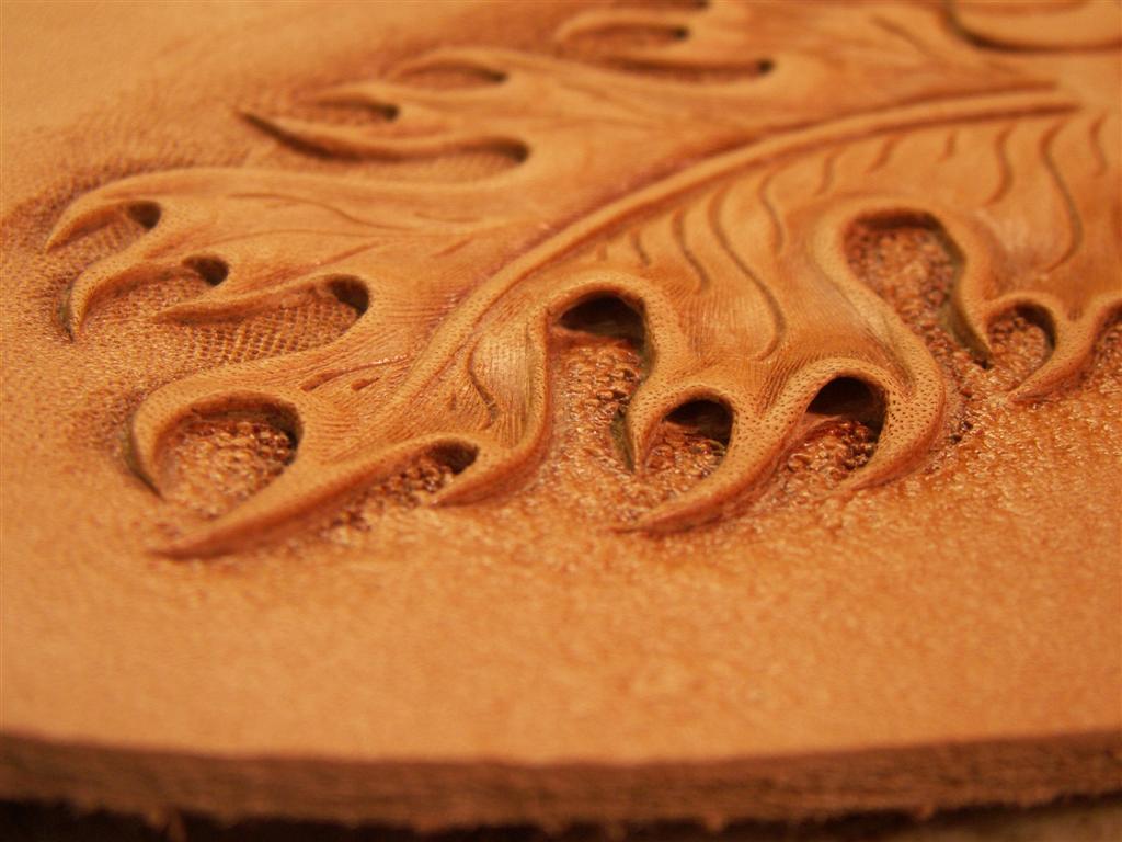

One thing you have to do is make sure your pro petal tool is sharp. If they aren't sharp, they dont work well at all. Then it's just a matter of sliding it into the leather, usually on inside curves of leaves. Try to hold the tool at an angle so it will go about half way into the thickness of the leather. If you go in to shallow, the leather can rip out on top. Here are a couple of pictures, one with the tool inserted in the leather, the other of what it looks like when it is taken back out.

I've also found some marring when I use them. I usually try to get all my lifting done before I background. The backgrounders will cover most of the tool marks around the lifted areas. Also be really careful that the point of the tool doesn't cam out and the point skips across the work. It will ruin your day...and your work!
as usual Clay- beautiful work. I've noticed on you pieces that you have a great, how do I say, vertical or flat border along your leave's edges. Do you use a thin blade and do you bevel AND mat before you background? I don't seem to get the "depth" with my tooling even though I cut and bevel as deeply as you do.

Clay, Not only is that a great looking leaf, but the background is outstanding. Is that a Beard stamp?

Thank you Pete. That was just a demo piece I was playing with. I dont normally mat before I background. One thing I found for getting depth to my backgrounding is to use a small background tool for most of my backgrounding. I can get a lot more depth with a small tool than a larger one. It takes more time, and sometimes I have to go over it several times to get it smooth. Sometimes after backgrounding, I will even re bevel and then background again for greater depth and to even it out. You have to have your leather glued to something though if you do this to keep it from stretching way out of shape. I am starting to think there is a point where the leather will not compress any further. At that point, your background can get pretty smooth, and you will usually get good color too. As for knife blades, I am still trying to figure out what I like. I use an old Craftool angle blade, Peter Main's low angle blade (made by Henley) and recently got a couple angle blades from Bob Beard. I switch around a lot.

Thank you Mike. It's the Hidecrafter version of the Beard pebble backgrounders. They are my favorite backgrounder to use these days.

Clay- the close-ups look really neat. Did you use a hair blade on the leaves or is that the lines from a vertical thumbprint/pear shader?
