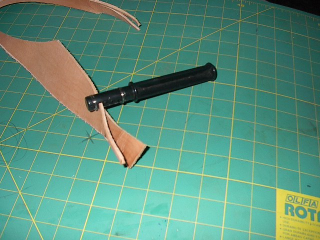

Members SmilinJim Posted October 7, 2007 Members Report Posted October 7, 2007 Hi folks, A while back I decided to try some braiding, not easy for an old dog to learn new tricks. After reading awhile I made a lace cutter like some shown in the 'books' ,thats pic 1, it actually works but there had to be something better. Asking questions on the board brought a response from Ken(Beaverslayer) and I learned to crank up the tandy lacemaker. A whole lot better, that's pic 2. But I can't leave well enough alone. Had trouble finding thin leather close to home, about 2 hours to tandy. I decided to strip veg tanned, all I had was some 5-6 oz stuff and it didn't fit the tandy well at all. So what the ... let's make one. So I went down to the shop and came up with this. It's not pretty but it works too. pic 3. You just can't start with a 2" hole, has to be bigger. But it works with a variety of different blades that I can get locally and cheaper. Also I can make several handles and cut the notches to whatever size I want. Put a little varnish on it to seal the edges. But again 6 oz veg tan cut thin doesn't braid very small either. So how about a small splitter to downsize the strings. That's pic 4. It too will handle a selection of blades and you can control the thickness of the string with a small screw so the thickness stays constant. I've thinned 3/16" to 1/2" width strings with it with no problems. With a sharp blade you can cut extremely thin. I did a 4 strand round braid from veg tanned for a necklace for my wife. Finished thickness is just a little over 1/8" in diameter. That's pic 5. Now for a question. I cut some 3/8 strings and thinned to about 1/32". I then took the split(suede?) that was left and braided it as a 4 strand round braid and used that as a core. Then used the thinned strips and braided over that. That's pic 5. Give me comments on that as the use for a core. Not real flexible but will work as a case handle. Any comments are welcome. Keep on Smilin Jim Quote
Ambassador Beaverslayer Posted October 7, 2007 Ambassador Report Posted October 7, 2007 Jim, As they say, "Necesity is the mother of invention" Great job on the cutter and splitter. And nice looking braid as well. Ken Quote Beaverslayer Custom Leather<br />Wearable Works of Art https://www.facebook...erCustomLeather
Members Dan Hammons Posted October 7, 2007 Members Report Posted October 7, 2007 I think you could sell some of those little strippers{leather}. Quote If you haven't got time to do it RIGHT How are you going to find the time to do it OVER ! Dan Hammons http://highcountryleatherart.com/

Members Mike Phelps Posted October 7, 2007 Members Report Posted October 7, 2007 Hey Jim! I REALLY like that splitter! in picture 4. I've been trying for a while to cobble one together using disposable utility blades by making the blade adjustable. Without much success. But if I'm looking at and reading you right, the block in front of the cutting edge of the blade moves up and down with that screw in the center? The bolt at the rear acts as the pivot for the adjustable block? Oh man did I ever have it all ass backwards! Back to the barn for 40 lashes! And try again. Quote Freedom grows where gamcock crows
Members SmilinJim Posted October 7, 2007 Author Members Report Posted October 7, 2007 (edited) Hey Mike I think that's incarnation 4 or 5, I started the same way. I've got another version that uses a dowel for the pivot point for the lace. works the same way. Don't know if either is better or worse. Put a notch along one side of the block so you can feed the lace into the blade as you slide toward center. You can use a lot of different blade, utility blades from walmart and the blades in the pics are from a beauty supply store. Cheaper, wider and are reinforced at the back Keep on Smilin Jim Edited October 7, 2007 by SmilinJim Quote
Members Mike Phelps Posted October 8, 2007 Members Report Posted October 8, 2007 Thanks for the additional pic Jim. Those blades would be for the straight razors that take replaceable blades. I've got a source or two[local beauty operators]for those blades and several online marketers of blades bookmarked. Plus I've got a dozen or more of the old straight razors around. Some had blades with bad nicks I've rehoned and could use, but that would be overkill as they are not really long enough to split leather for anything larger than cigar holders, medium size knives, maybe it would be useful after all to make one that size. Got a bone folder,creaser,burnisher, string beveler getting close to fitting the handle slabs on this evening. Cut from the same piece of bone and horn as the lacing fid. I think I'm on two a theme with these things. Thanks again for the pic and additional information. Mike Quote Freedom grows where gamcock crows
