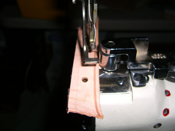

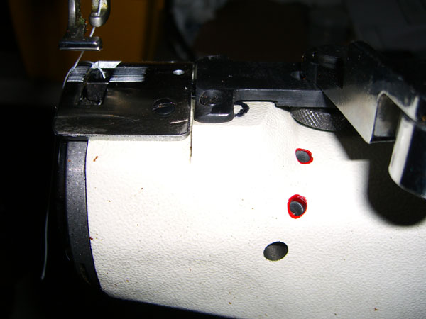

Bree Posted January 18, 2009 Author Report Posted January 18, 2009 (edited) I took some PIX of the problem. I put a piece of scrap with a crease to show how the needle is not going to get close enough and I took a PIC of the slope in the csting that is causing the problem. As Jerry said this appears to only be a problem in the LA-25 models. They are going to have the castings changed. You can't beat that for customer service. Edited January 18, 2009 by Bree Quote Ride Safe! Bree 2003 Dyna Wide Glide Memberships: Iron Butt Association, Niagara Falls HOG, Wild Fire HOG NRA, Niagara County Sportsman's Association
