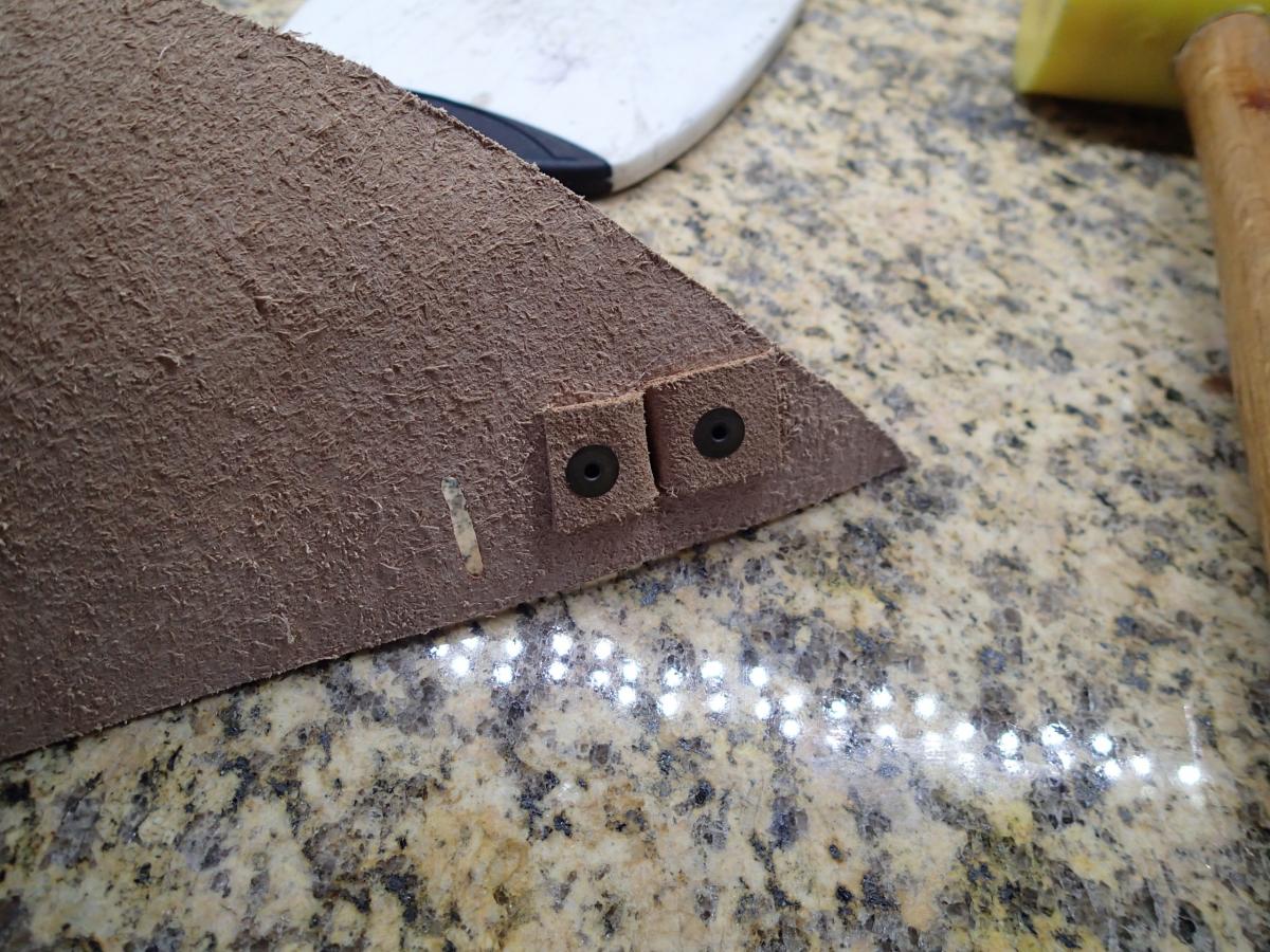

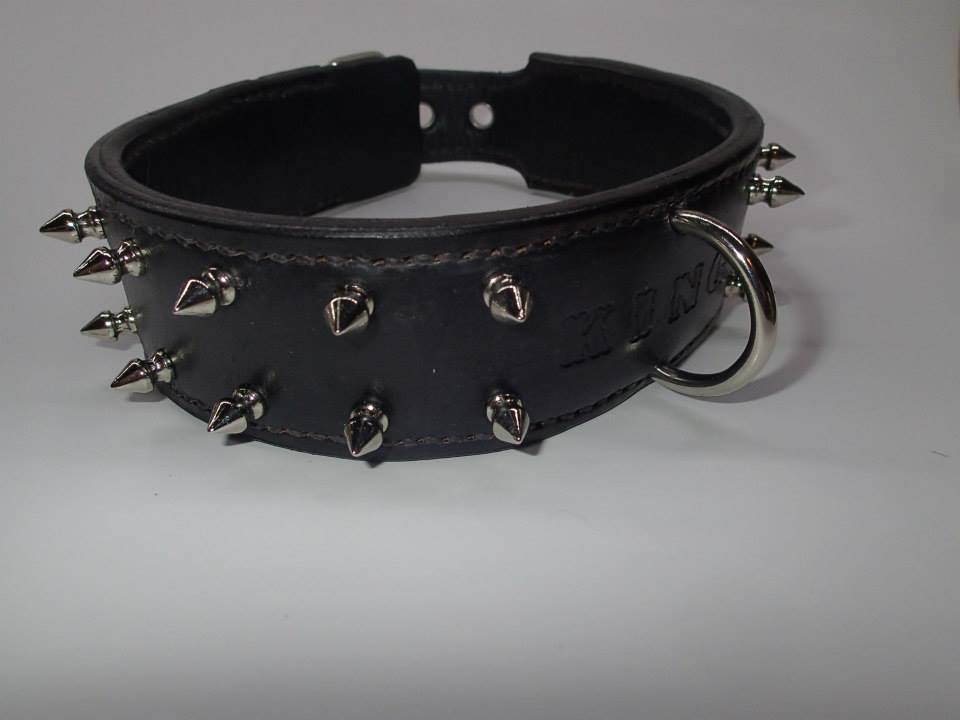

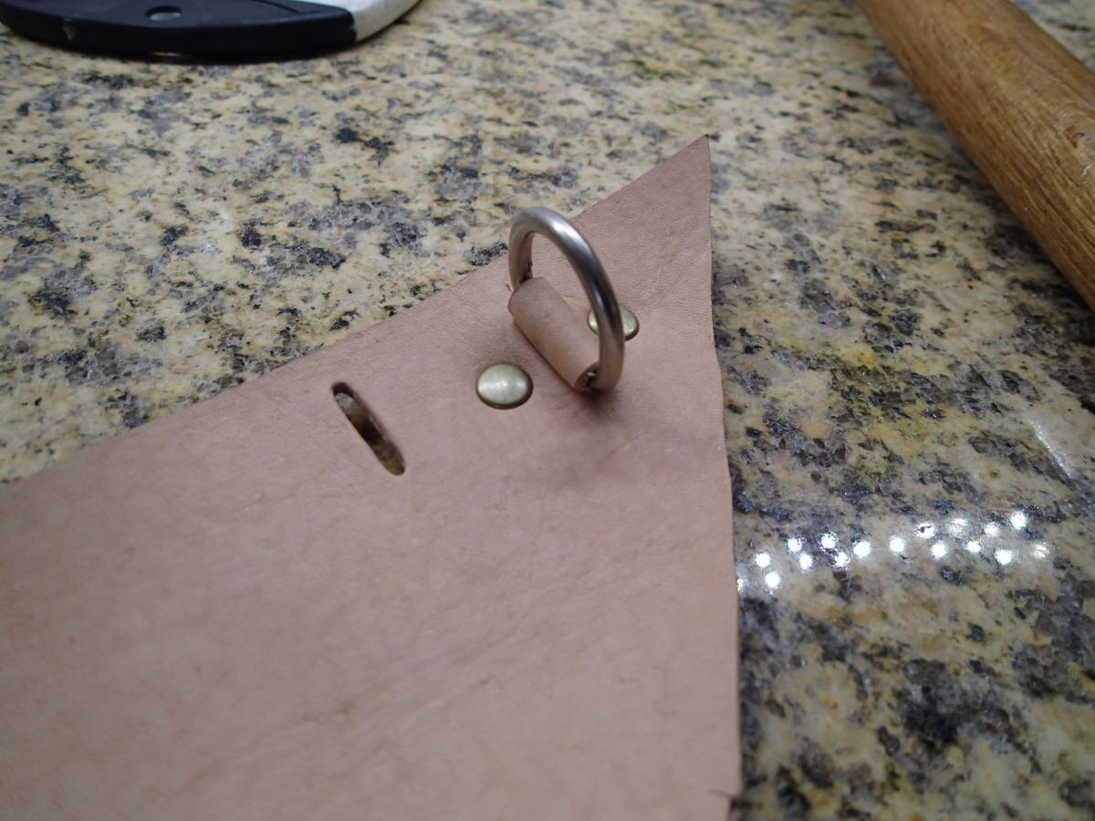

I would recommend punching a slot and pulling the leather up through it. Then you can rivet on both sides to hold the d-ring in place. The other option would be to sandwich the d ring between two layers, as in the dog collar.
post-58856-0-06557200-1427924757_thumb.j
post-58856-0-63438900-1427924724_thumb.j
post-58856-0-52226000-1427924673_thumb.j
post-58856-0-83687600-1427924699_thumb.j

Tom, I do like the look and neatness of how you have done it in photo 2 though I'd imagine there would be a little bit of bulk on the back.

Usually when I am doing this, I skive the leather (taper the ends to a thinner profile) in order to reduce the bulk. The finished product with a lining isn't that much thicker.
