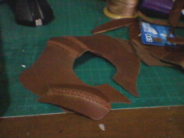

I attached a few test stitches... I'm enjoying the process. :)

Hard to tell what type of leather you have from a picture, it may be latigo. In order to wet mold you want Vegetable Tanned Leather. Tooling leather is always veg tan. If you want small quantities of leather (less than a side) then the only place I know of is Springfield Leather Company, they will sell you high quality leather tanned by Hermann Oak. They sell in quantities as small as 2 sq ft. Thinner leather (4oz or so) will mold, however the thicker leather 8/9oz or so does a better job. Hope this helps, others may know of other places that sell small quantities, Springfield Leather is good, their turn around time to get the order picked and shipped is a little slow. They are good to deal with.
