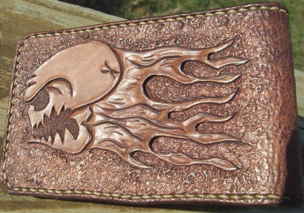

You can tool horse butts. It takes a heavier hit with a mallet, and keeping the leather a little more moist than with steerhide. Horsehide is naturally water resistant, so casing can be a challange. I get mine wet, and leave them in a ziplock overnight. Attached are pictures of five horsehide wallets I have made. I love the look of it when it is dyed, and you can't beat the durability. I use a 20-24 oz maul to tool, and have broken two plastic maker mark stamps in it. You have to hit it signifigantly harder. I also switched to a 4 inch thick granite slab about the same time I started tooling horsehide. The other challange is that the hard rolled horsebutts like Springfield sells will spit sometimes if they are not oiled enough before folding. I always wet fold my wallets now, to try to avoid it. Take a look at the last wallet picture, and you can see the crack starting on the bottom.
