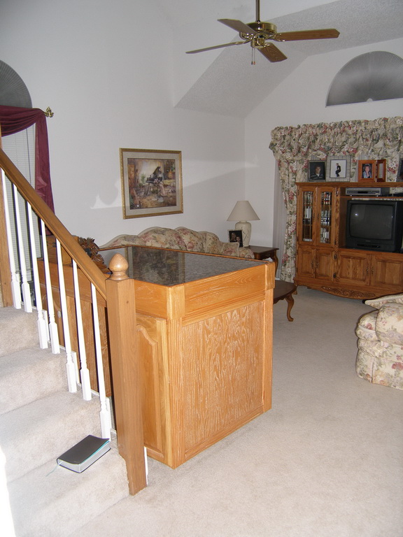

Members Go2Tex Posted January 16, 2009 Members Report Posted January 16, 2009 (edited) Thanks Ben for a second look at the beautiful tooling cabinet bench. I'm surprised you don't get some bounce off those casters and rubber mat, but apparently not. That cabinet is so pretty I bet Mamma lets you leave it in the living room, eh? Yeah, it's not the particle board itself that's bouncy, I don't think. It's a solid mass. It's the structure under it. The 2x4s are yellow pine and warpy as heck, so it's not a good, flat surface to begin with. I shoulda known better...... Edited January 16, 2009 by Go2Tex Quote Brent Tubre email: BCL@ziplinkmail.com
Members ABC3 Posted January 16, 2009 Author Members Report Posted January 16, 2009 Thanks everyone for your input...I'll get started. I bet the 3/4" Granite top cost a pretty penny. Quote NRA Member Certified Firearms Instructor www.agcustomgunleather.com
gtwister09 Posted January 16, 2009 Report Posted January 16, 2009 Brent.... I was wrongly thinking of something along the lines of the folding tables with the particle board tops. I have had to use them at other places when helping kids learn. "I'm surprised you don't get some bounce off those casters and rubber mat, but apparently not." ... No bounce! The casters are hard rubber with a 2500 pound capacity each. Not much give in them. When the bench was in the garage the rubber mat was on one side of the bench and not under the bench/casters. " That cabinet is so pretty I bet Mamma lets you leave it in the living room, eh?" Don't laugh!!!! Stranger things have happened. One of the concessions to wait in getting a place with a real shop was the moving of the bench. See Below for location. Yes. That's the front living room. Regards, Ben P.S. Tom...The granite was given to me when they were removing it from a building. If you look closely there is a small 1/2" square cutout in one corner. No one would buy the piece. So the whole bench revolved around the size of the granite top. The cabinet doors, 2X4's and casters were some wreckouts. The oak molding and peg board were some cutoffs. The only thing purchased was the 3/4" Oak plywood, hinges and knobs. Quote
