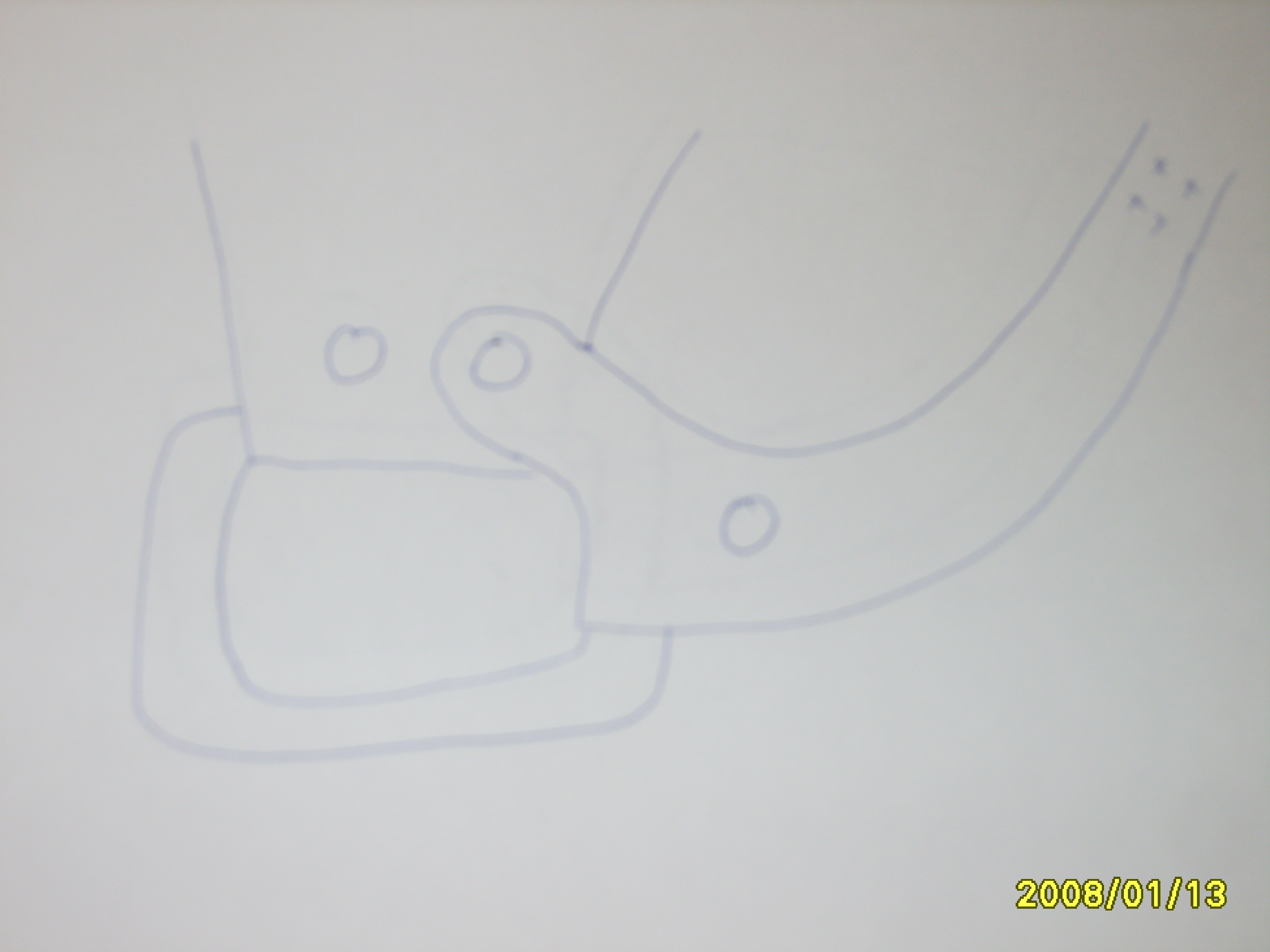

Bob Posted January 14, 2008 Report Posted January 14, 2008 Darc, I think Bruce said it best. it's to serve as a ramp to get the stirrup leather over the rigging. I've also seen the "Connecting strap" not connected at allto the back rigging, but to the bar just ahead of the cantle binding, coming down at 45 degree angle and wrapping around the rigging dee, also there's a "thumb" like piece that comes up and is rivoted into the rigging dee. I'm going to try uploading a sketch hand drawing of what I'm trying to say. Quote

Members greg gomersall Posted January 14, 2008 Members Report Posted January 14, 2008 Darcy a lot of the factory saddles use a piece of crap for this strap. Besides being a glide for the stirrup leather it is also a stablizeing deal. When run from the front dee to the rear dee the stabilizing factor is somewhat reduced but when run up to the tree as Bob showed it helps transfer some of the pull to the rear of the saddle. You don't need a heavy piece but it does need to be a choice cut of leather. Greg Quote
