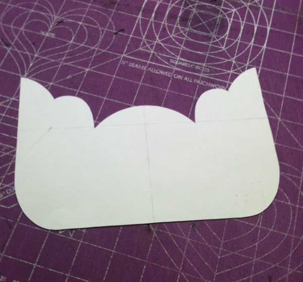

Remove design. You should have a decent line on the posterboard.
Cut out.

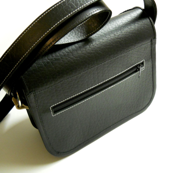

Sewn down.

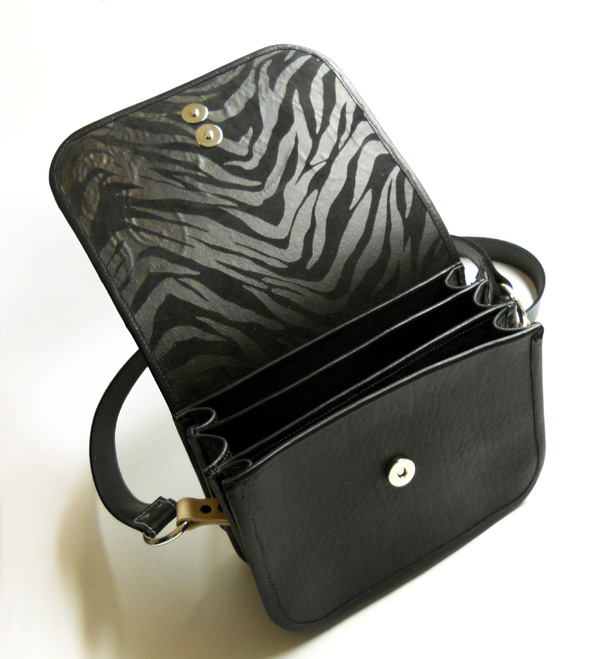

The finished product.
