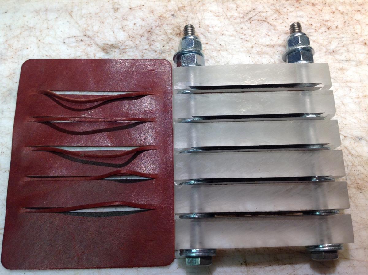

electrathon Posted July 12, 2014 Report Posted July 12, 2014 When doing this style of slot here is what I do. I made a slot cutter out of box cutter blades and spacers. Bolted them together. I lay the clicker on the leather and put it in my book press. Press it down. The two close mounted blades leave a thin strip of leather. I use a straight edge to align a punch and cut a round hole at the end of the slot, leaving a clean area for the cards to slide through. This sample is just a quick example on a scrap. With a little time you can get perfect slots every time with this setup. Quote
