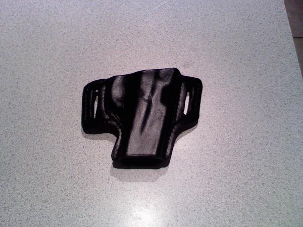

first try at holster
yldbill replied to yldbill's topic in Gun Holsters, Rifle Slings and Knife Sheathes
Randy, Since this was my first attempt I went to Tandy's and got some 6-7 oz leather to work with. The stitching was done by hand , with nylon waxed thread. I used a 4-prong punch to space the holes for sewing. The belt loops do look pretty rough but I wasn't sure how to dress them up at the time, I have read some more suggestions here and am looking forward to starting my next one. I think I know where I screwed up the first time. I only allowed 3/8 around the gun and because my pistol is a large frame I think I should have allowed 1/2 inch aroundthe gun. the current holster fits a Smith &Wesson but I don't know the model.. Thanks for the feed back and encouragement. -
This is my first attempt at a holster, it didn't fit my gun, but luckily it fit my future son-in-law's gun. Bill
