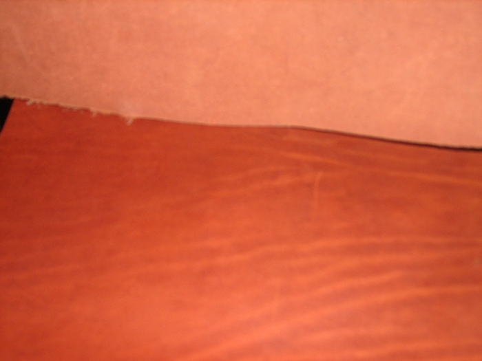

So I got some leather in from a shop in California that went out of business when the owner died. One of the pieces I got I'm not sure what it is. I know it's leather of course. The picture is as good as I could get as my camera seems to have a focus issue. It's thick like tooling leather but it's soft and supple. It's smooth on one side and the other side looks almost like it's got a thin cloth on it but still kinda like suede. It's a slightly reddish brown with lighter "stripes" or streaks or veins in it maybe from being folded or rolled. I want to use it to make a pair of hardened bracers out of and use some of the soft suede that I got with it for a liner. I hope this describes it enough for one of you experts to help me. Oh yes and here's the crap ass picture of it.

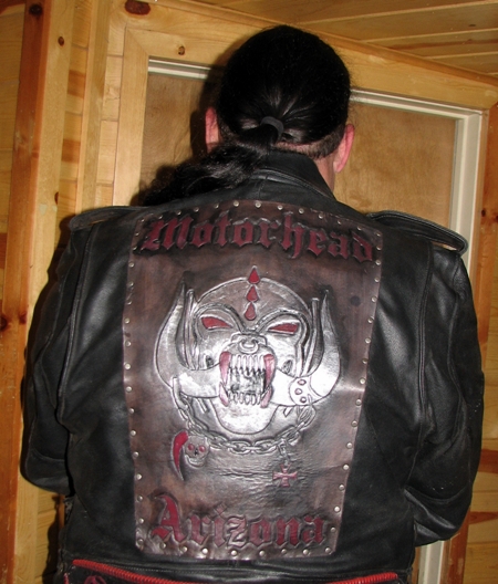

Motorhead backpatch finally done
DreadPirateRedbeard replied to DreadPirateRedbeard's topic in Motorcycles and Biker Gear
Thank you everyone for your kind words, coming from the great artists that you are, it means tons to have positive reviews of my humble works. Tom, they've often been labeled as the loudest band in the world. I've seen em 4 or 5 times and they never disappoint. Lemmy is the reason that I play bass. I really suck at it but it entertains me and irritates the neighbors. Right on Brian! The rivets were a faster alternative to sewing it on andd I really like the look it makes. Thanks tat2. the spacing is a result of my cheating using the ol' PC. I downloaded the font that best matched their stuff, used MS Word or some such program to make it what I wanted and printed it out. Then simply put it to tracing film on my handy light box and transferred it to the leather for processing! I'm glad you mentioned something about waterproofing as I spaced it completely. I'll probably heat up the wax, brush it on and use the blow dryer to set it in and get rid of excess wax. BTW, what's Sheridan art? That's a noob question hehe! I have been here a month or so now nad just decided to experiment with some of the techniques that I've read about here and prayed that they worked! Thanks G. I just say f**k it and dive right in. I was very frustrated during a lot of this project though. For instance, when I combined a nice red with the metal flake silver and it turned out to look like pink f**kin glitter nail polish, I almost tossed it out. But I let the pink crap dry, then applied a couple of coats of just red. When I was finished with the detail paint/dye work, I slathered it all in USMC black and wiped it with a cloth soaked in paint thinner and it became what you see. When I started chain maille in 2000, I was told that I should not do a shirt or any large pieces like armour because a noob could never do something that complicated. I did not only a shirt, but it had a brass inlay of three chevron stripes. My blacksmithing is the same. I have never been taught any of these arts formally. But now I'm building my own coal/coke forge from freebie junk and thrift store parts. I'll be putting some hand hammered steel pieces on the jacket next after the forge is built. So for any newbies reading this, Have the courage to do whatever project you want to do, big or small. Ask any of these amazing artists on this forum. Compared to their works of art, my stuff is nothing. In just a month on this forum, I've learned so much from these great people. They have a lot to offer and they're some of the nicest people I've never met! So now I am off to ask a question about some leather I just received and hope for a response or two, then start in on a pair of hardened bracers! -
So it's finally done. It's taken me two weeks to get this thing done. But I learned a LOT during the process. The logo looks much darker under normal light. So after all the carving and tooling, I took a chance and mixed a bunch of browns and a couple of other colours from my Eco-Flow dyes. I tested it and liked the look so I covered the whole thing in the mixed dye. Then I ran some USMC black dye over the lettering and logo and painted the areas with a metal flake silver and flat red paint. At first, i mixed hte metal flake silver with the flat red but when I applied it, it looked like pink glitter nail polish so I had to go over it with just the red. Then I ran the USMC black over everything again and wiped it down with a rag soaked in paint thinner which took dye and paint off of some places and left it on other spots. Then I riveted the piece to my jacket. I'm hoping to get some better pictures that show the highlights and such. Please feel free to check it out and give me your constructive criticism.
