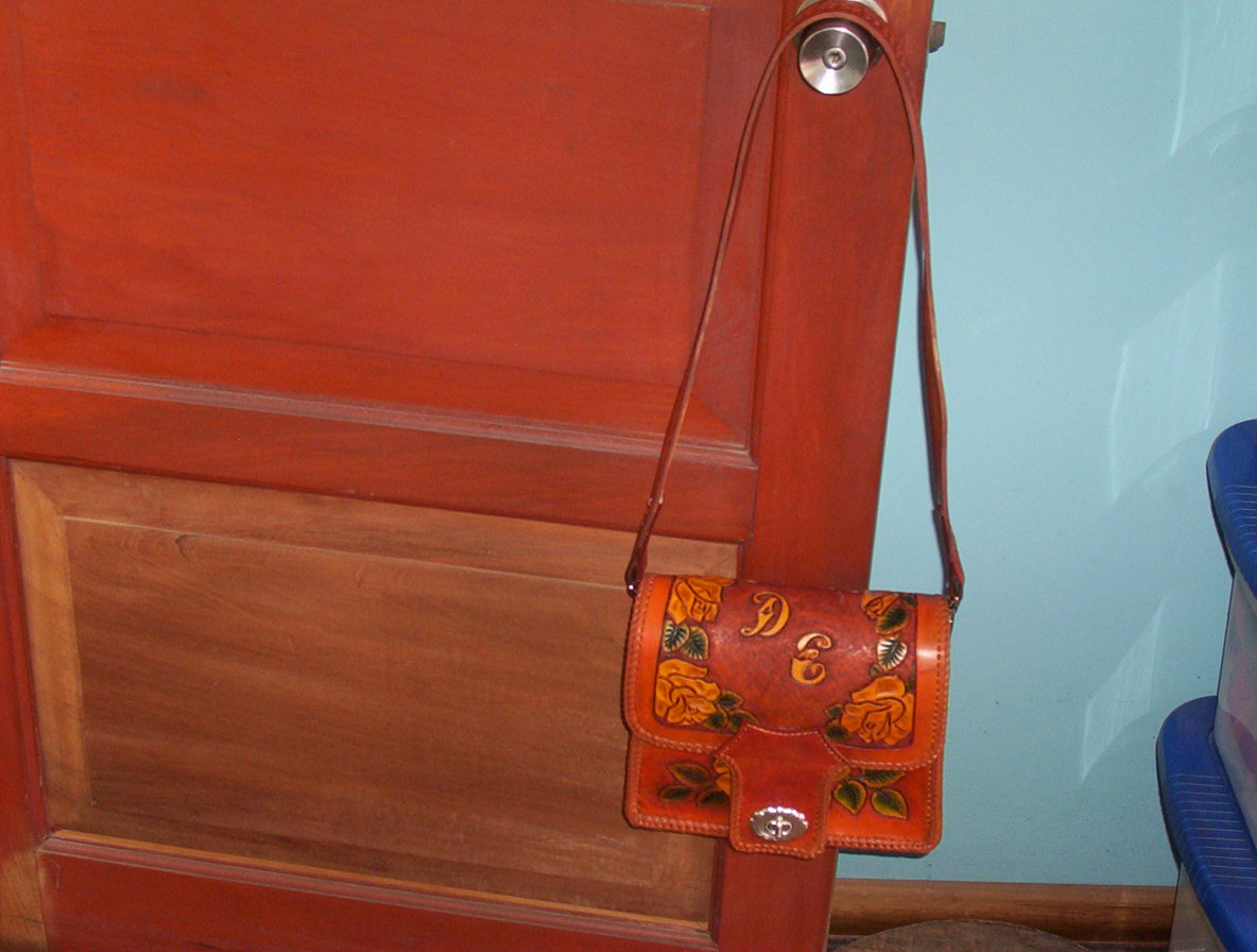

  15. This is a handbag I made for my sister. Colors are spirit dyes finished with Eco-Flo Saddle Tan antique gel. I used 1/8" tan lace with double loop stitch in the places with just two thicknesses and triple-loop stitch in the places with four thicknesses.
