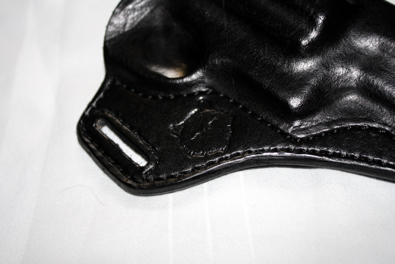

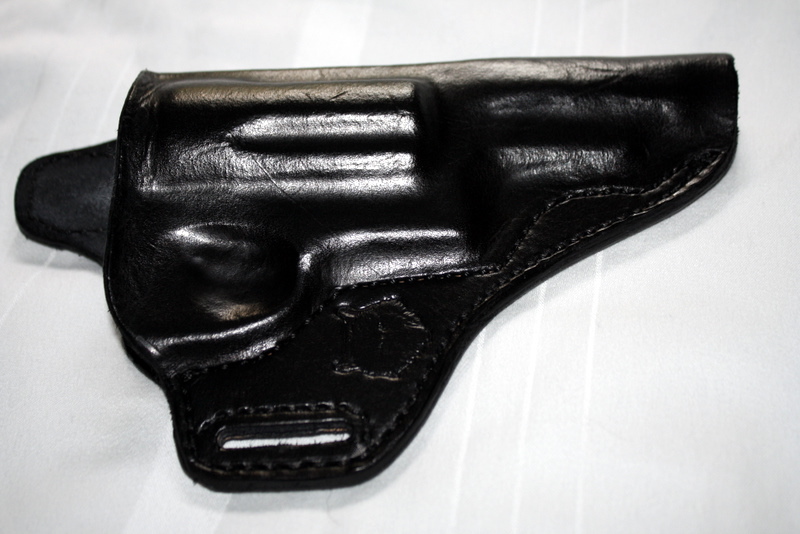

Holster For Judge
spblademaker replied to spblademaker's topic in Gun Holsters, Rifle Slings and Knife Sheathes
It got a little thin up there. The support in the back will hold most of the weight, though. The back has a double loop set-up. I actually could have removed that entire side of the holster, and probably should have. -
Just finished a holster for my friend's Judge. His poly Judge broke so he went back to good old steel!! 9/10oz with USMC black finish.

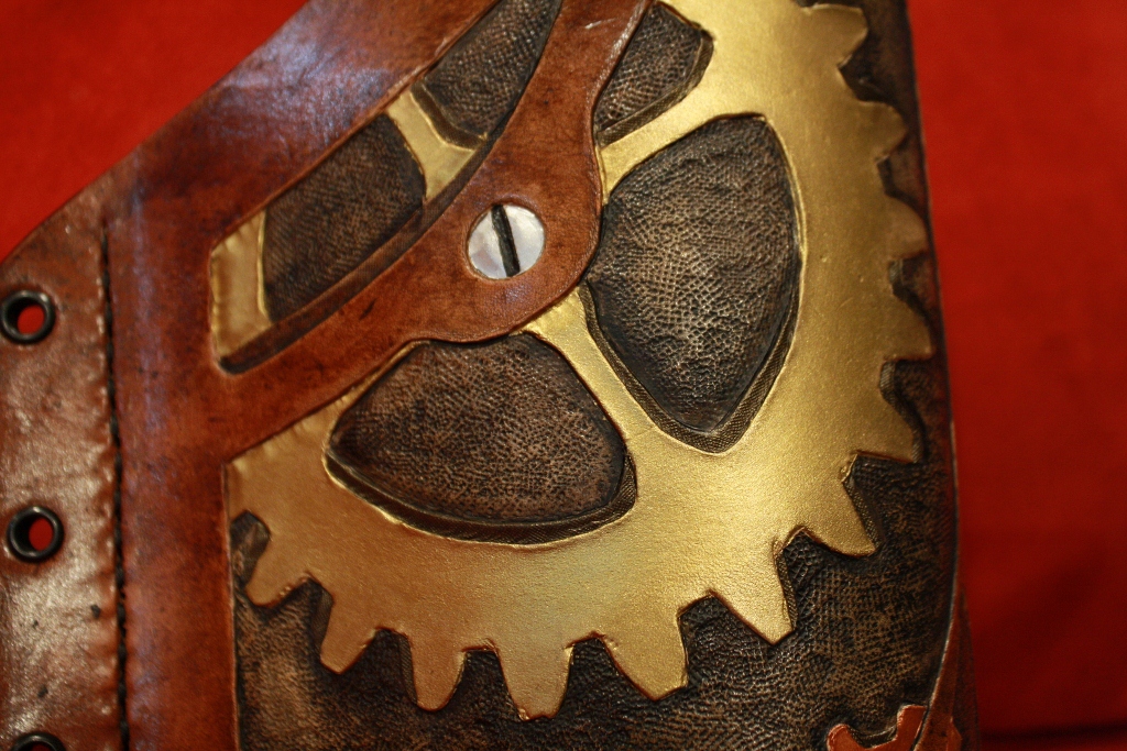

Thanks. It was my second attempt at tooling. The smaller gear was a pattern I had from Tandy. I just modified it a little.
Here are some pics of a steampunk holster I was asked to do. I used 9/10oz and multiple dyes, stains and acrylics to complete the work.

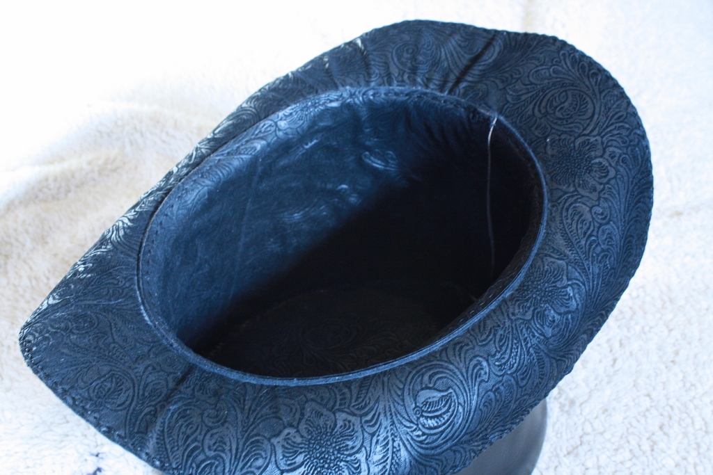

This is the first hat I posted now that it has a finish on it. My first attempt at tooling was glued and sewn to the side. This hat will become my "test hat". Now I have to get a liner into this one.

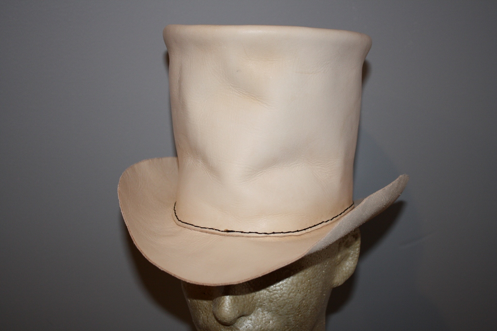

Well here is the top hat drying on the head. It was my first hat and I was very happy to finish hand sewing. I still want to glue a bottom piece to the rim and burnish the edges. I was thinking of going with black or maybe mahogany.

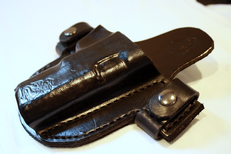

OK, I tried to use most if not all of the help offered on this project. I am very pleased with the progress of the finished edges. I need to spin some burnishers on my lathe to make things easier the next time. I used a rasp to knock the sharp edges down prior to burnishing. I then wet the edges and burnished with a nylon wheel. I then re-dyed the edges and put a finish coat on the entire holster. What do I need to focus on the next time?

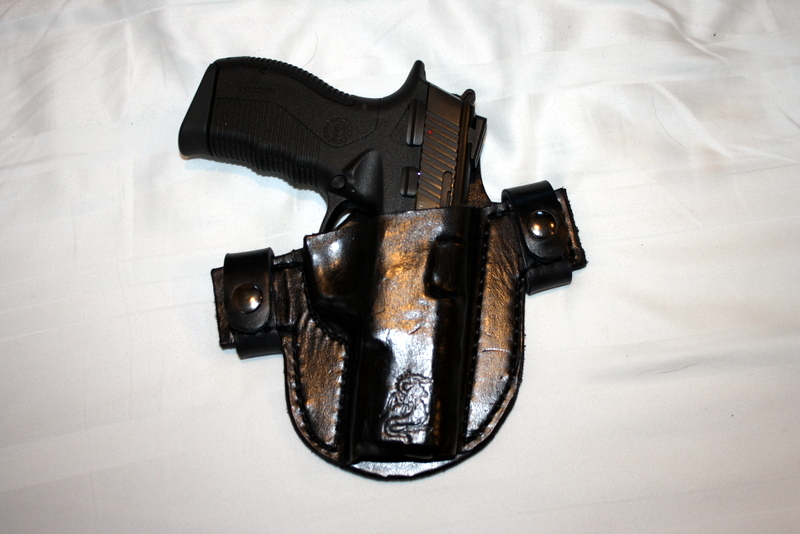

First holster, feedback please
Ok, I'll try that technique with the revolver. I'm also trying to design a kydex clip that would snap over the trigger-guard and be covered by the leather. That way the holster would work like the kydex style and have the leather look to it. -

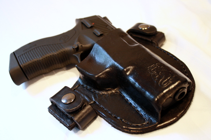

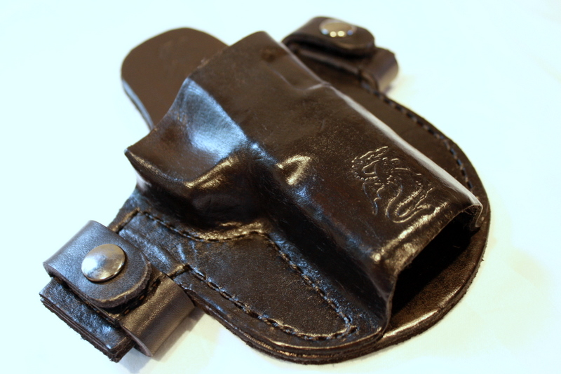

Thanks for all the good info. I am aware that the egdes are the weakest part on this piece, but I can finish them. I'll run the edges on my belt-sander with a fine grit. At the same time I'll round the edges. Then I will try a burnishing wheel and some wax. I'll look into the snaps as well. I dyed each piece prior to stitching. I also did the wet mold prior to stiching. I was unsure about how much the leather would stretch and didn't want a holster that was too tight. I've bought a few of those and won't use them. The gun has a poly frame an sits very well in the holster. I actually used a Comp-tac holster for the basic design. I'll use all the info and post again after the details are touched up. I am also making a holster for a revolver. Thanks for the input. -
Here it is my first big leather project. It was designed because I couldn't find a good holster made for my pistol. So I decided to make one myself. A few people at work have already put in orders. Give me as much feedback as possible. Thanks.
