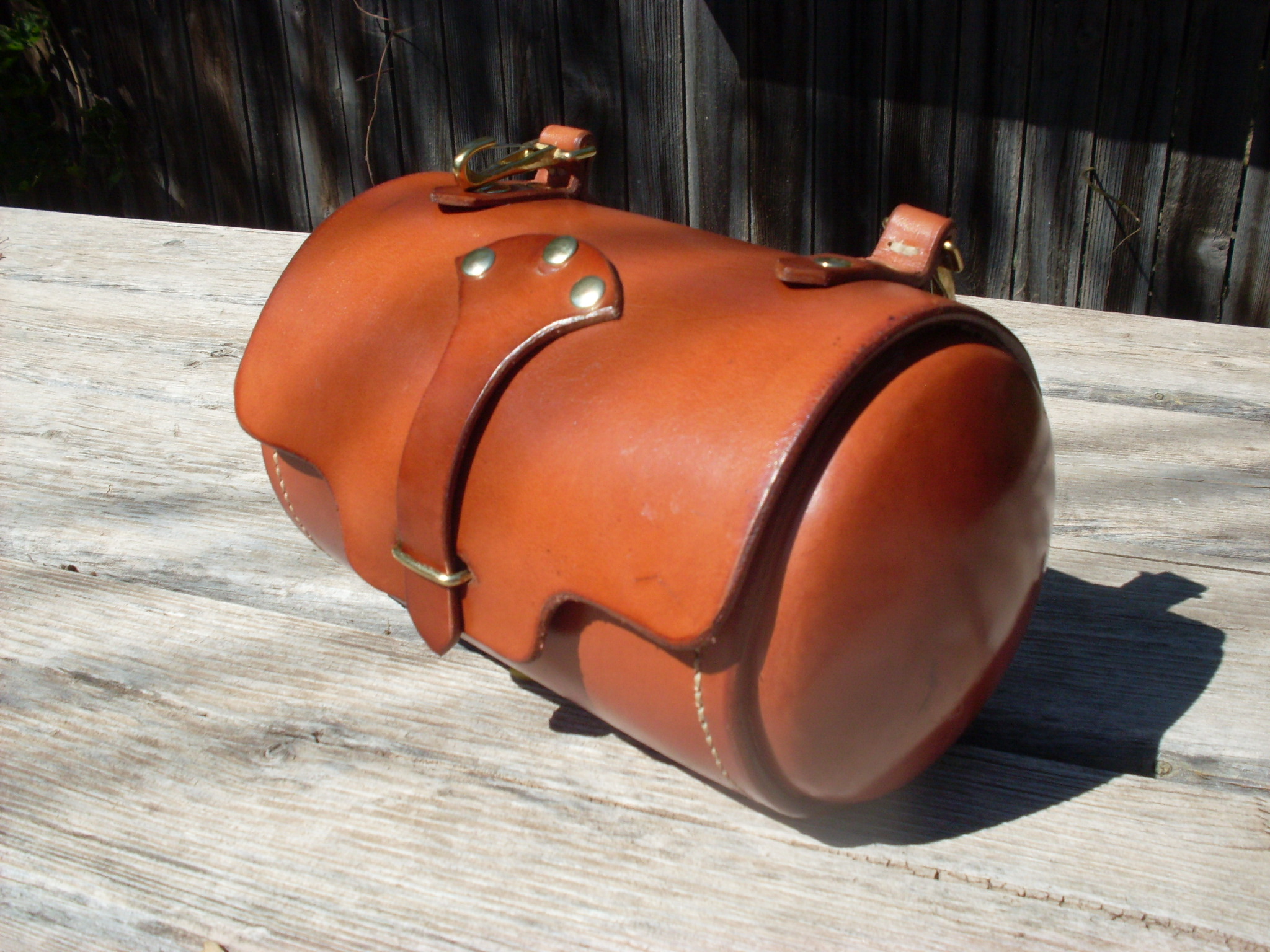

As promised here is how I build and install a fail proof system for keeping my bicycle bags closed. (Move Left to Right while looking at the photos.) 1 Bag with long slot cut in flap and strap lined up with it and about 1 inch longer than the flap. On this bag the strap and loops for holding the hooks are one. 2 Tools and materials. On this bag I'm using Al welding rod. You can use brass brazing rod, heavy copper wire or even nails. 3 A finished keep ready for installing. This is a jig I made out of 3/4 inch angle iron to bend the keep. NOTE: Al will crack if bent to sharply. It is soft enough to bend with your fingers and then gently tap with a hammer. 4 Fold the flap down and use a piece of the metal to mark where the holes need to be. 5 Because I don't have a satisfactory way to back the leather to punch it, I simply drill it. (I do finish the hole with a touch of edge coat) 6 Keeps pushed into the holes in the bag. (Imagination time! Next four photo are not an actual installation - because I can't get a camera into the bag!) 7 Keep pushed all the way through the bag and a spacer block set between the prongs. 8 Prongs folded over and trimmed. (This does take work on brass and steel! Of course if you able to do it in a larger space . . .) 9 A leather patch is glued over the keep to prevent it from being pushed into the bag. I've use white, contact and Super with success. 10/11 I use a spring clamp and some medium dense foam to hold the patch in place. 12 Bag's ready for some finish touch up and onto the back of a Brooks Saddle. That's it. Simple, inexpensive, functional and if needed, easy to repair along the road. WesTexas
No problem. It will take a couple of days however. I sold the bags and am about ready to sew another one tomorrow. The fastening system would work well on your bags. It's what I have on my panniers - bicycle saddle bags.
Thanks to everyone for their comments. The fastening system may have come from or was inspired by an early 20th century piece or how we kept a gate closed when I was a kid. I honestly don't remember. I use brass brazing rod and aluminum welding rod to make my own rectangular keeps. A light hammering, a quick buff and some lacquer will give them a nice hand forged look. (This one is plane to match the rivets.) The objective, besides keeping the bag closed, was to eliminate the potential failure that might be found in snaps, buckles, clips, etc. I'd rather ride than fuss with equipment. That being said the clips that fasten to the saddle are used rather than a leather thong because of greater security and ease of getting the bag off and on. Even if one of the springs fails, the hook will hold the bag.
