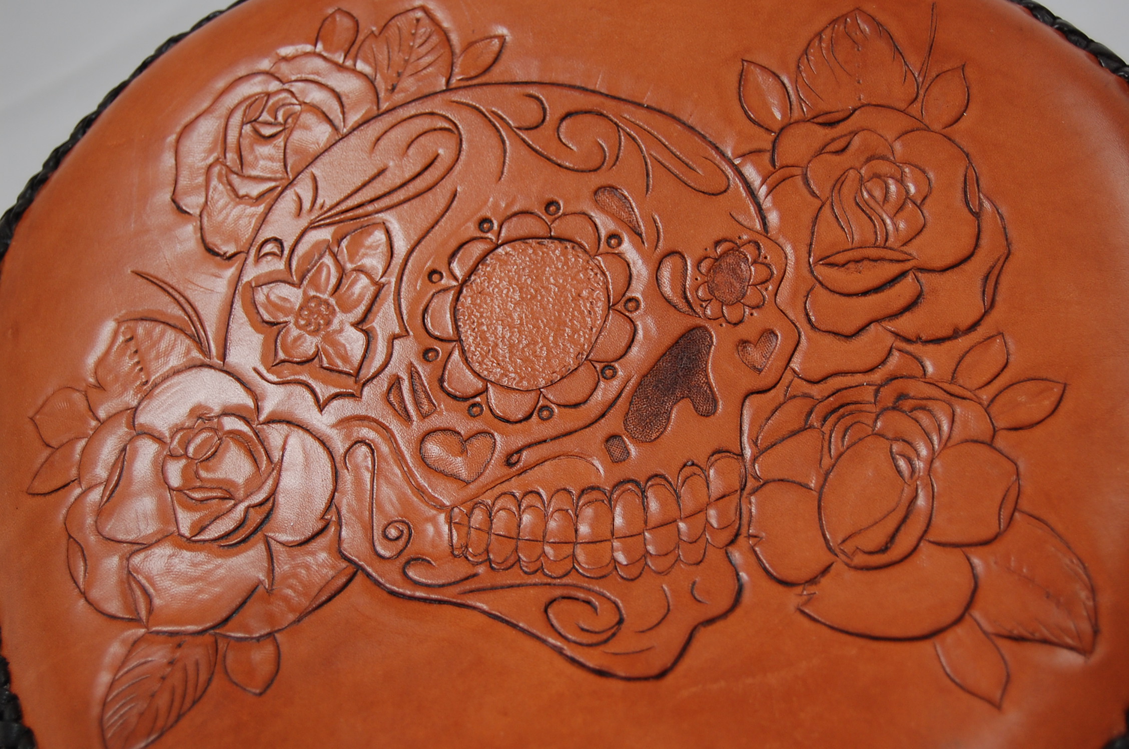

Ok, Here's the completed seat. Critiques are certainly welcome. I dyed it with fiebings dye and used an airbrush to fade it from a mixture of medium brown to saddle tan. Finish is leather balm w/atom wax. Is that good? I read that it's not really a water resistant finish but have read others that use it. I rubbed it in pretty good while applying it and buffed it when dry. I had trouble with getting pictures to look like the seat does and my battery died before I got the back. I'll try with a light tent when I get home. -

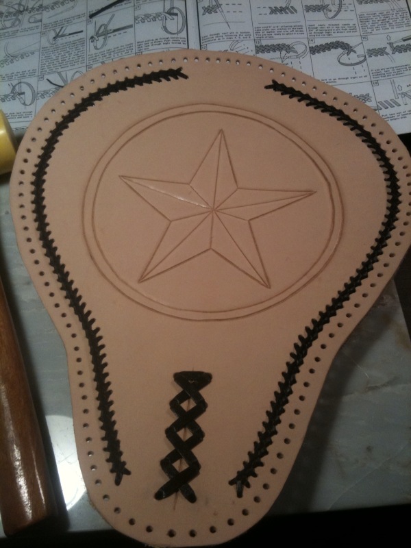

I just finished my seat and need to now do the dye, antique, finish..... I wasn't to happy with how the last one came out and I've read every post on here trying to get a good method but I'm unsure of the order. So how would you finish this with these products? What I have; denatured alcohol neatsfoot oil fiebings spirit dye(tan) fiebings oil dye (saddle tan) tan kote feibings dark brown antique paste IMG_0991.JPG fiebings leather balm with atom wax. Sno-seal. I don't have to use everything but that's what I have. Im planning on getting an airbrush too. The seat is made with 8-10 oz Wickett & Craig leather and the lacing is 1/4 roo w/ 1/8 holes and the applique lacing is 1/8 roo.
I've seen the kickers. They are alright, but I was trying to think of something different. I think you nailed it with the seat. Removable isn't really needed since I'm usually carrying a pistol. Although I seen everyones comments about the legal issues and although I doubt it would be a problem Id rather not draw any more attention to my bike than needed because if I did get pulled over for it they'd probably give me a hard time for everything else too like no turn signals or horn or inspection. I started on my second seat now then I'm going to make one for my bike. I'm doing some decorative lacing on this one to practice and getting an airbrush to see if I have better results with the finish.

I really thought about it since it is nicer than the cheap eBay seat I have now, but i made it for practice and the skull really isn't what I want on mine. I ordered another pan and the new leather so I'll make another one. Id also like to do a little more decorative lacing on mine. I also spent most of the day reading Paul Burnetts site and hopefully learned a lot about carving and tooling. I think I learned I need more tools too. I read somewhere on here that Christian from Xian leather only bevels his work, is that the case? Or did I mis understand. I checked out his site and that's what it kinda looks like and it looks great even though it's a different style than most.

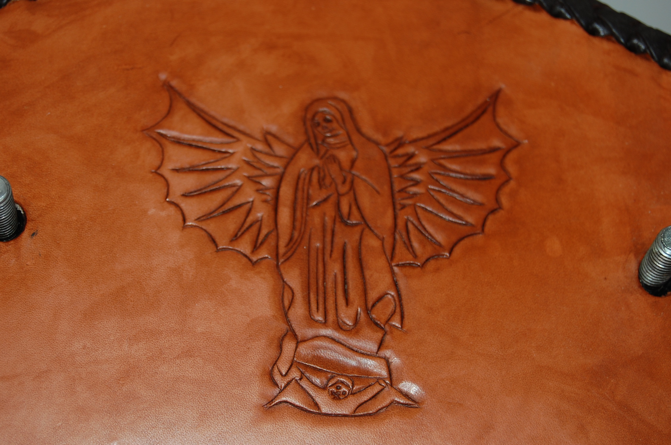

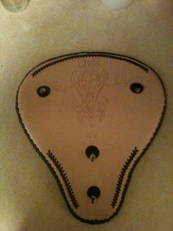

Hello everybody, Long time lurker first time poster. This is my first seat and first real project other than the starter kit things. Any comments good or bad welcome. I had a bit of trouble with the liquids on this, mainly on the back side (luckily). I used Tandy leather and Kangaroo Lace. I ordered some Wickett& Craig leather so I'm looking forward to using good stuff. I've only been working on leather for a couple months, I got into it to make a seat for my bike but now I can't stop. Thank you to everyone, I couldn't have completed this without this site and especially David T. for all the information he has shared on this forum. Hopefully my pictures work on this. [/img] [/img] [/img] well looks like my pictures are too big. I'll have to see about fixing that Heres the back side.
