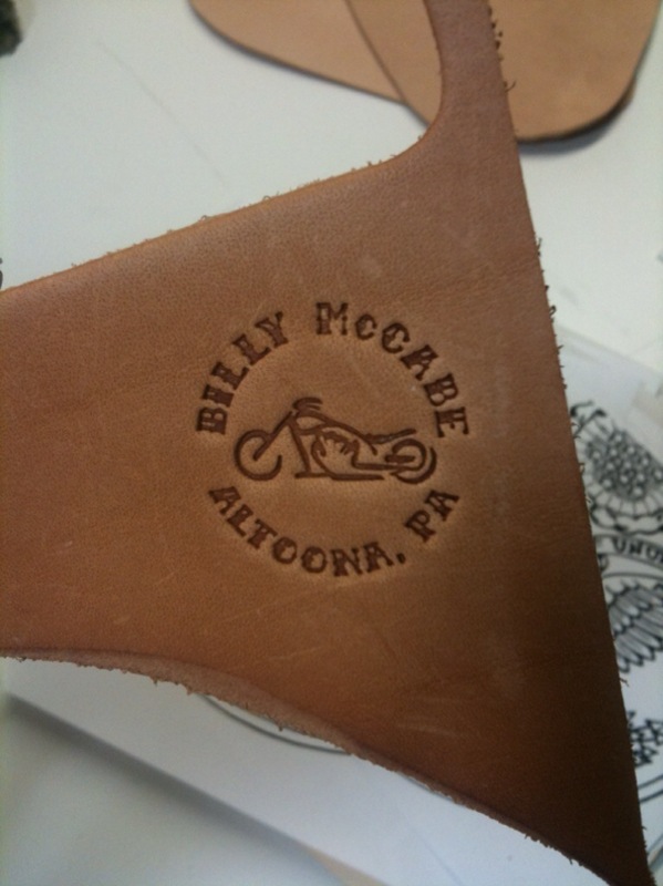

Well I bought one, It seemed silly not to for the price and it looks much better than what I was doing. After thinking long and hard I ended up putting no thought into it. I emailed Brenda, gave her some basic info on what I do and she came up with a few different ones and I picked my favorite. She was very easy to work with and very quick, I emailed her friday and had the stamp in the mailbox on Wednesday. I may get another one later on that is smaller, but this one is good for my seats.

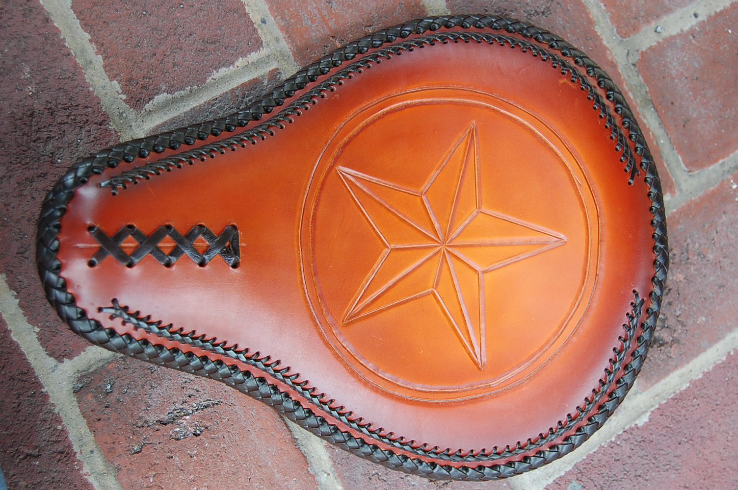

it certainly looks more challenging to do that style of seat. I figure more people have those though so I should learn how. I ordered another seat in the event I mess it up or it takes me a while, I also wanted to suprise her with it but I might not be able to if I have to redo the padding. I Kinda need to sell some of the other ones to buy more leather. I'm working on a new work table this weekend so nothing else is getting done, but my work area will be much bigger and sturdy and I'm putting another light up.

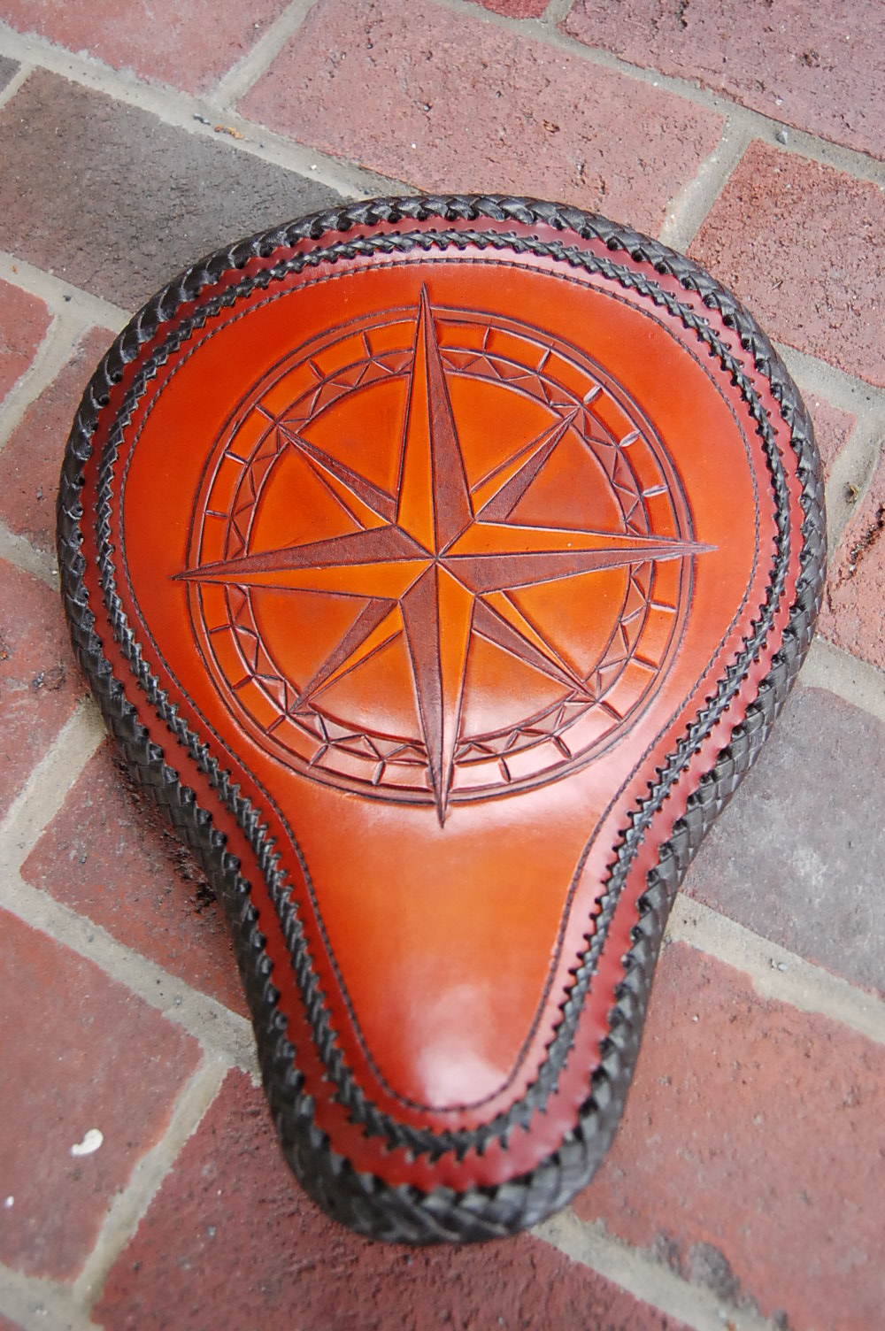

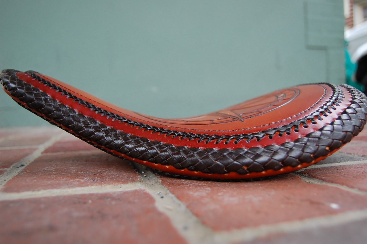

Here's the latest seat. It was meant to be for my bike but I glued the back on slightly off center. I want mine to be perfect since it will be kinda like my display model in a sense. If it was mounted I don't think it'll be noticable but I'll probably be flipping mine up quite a bit to show it off. Anyway 8oz Wicket&Craig All Kangaroo lace A combo of Tan, saddle tan, and med brown dye I used antique this time and I really like it. I looked at my other seat and it looks plain without it. I finished this with sno seal and feel a little more confident on the water resistance and it looks just as good, it buffed to a nice shine. I put the other one on my bike with the leatherbalm and got a few small waterspots on the bottom side.

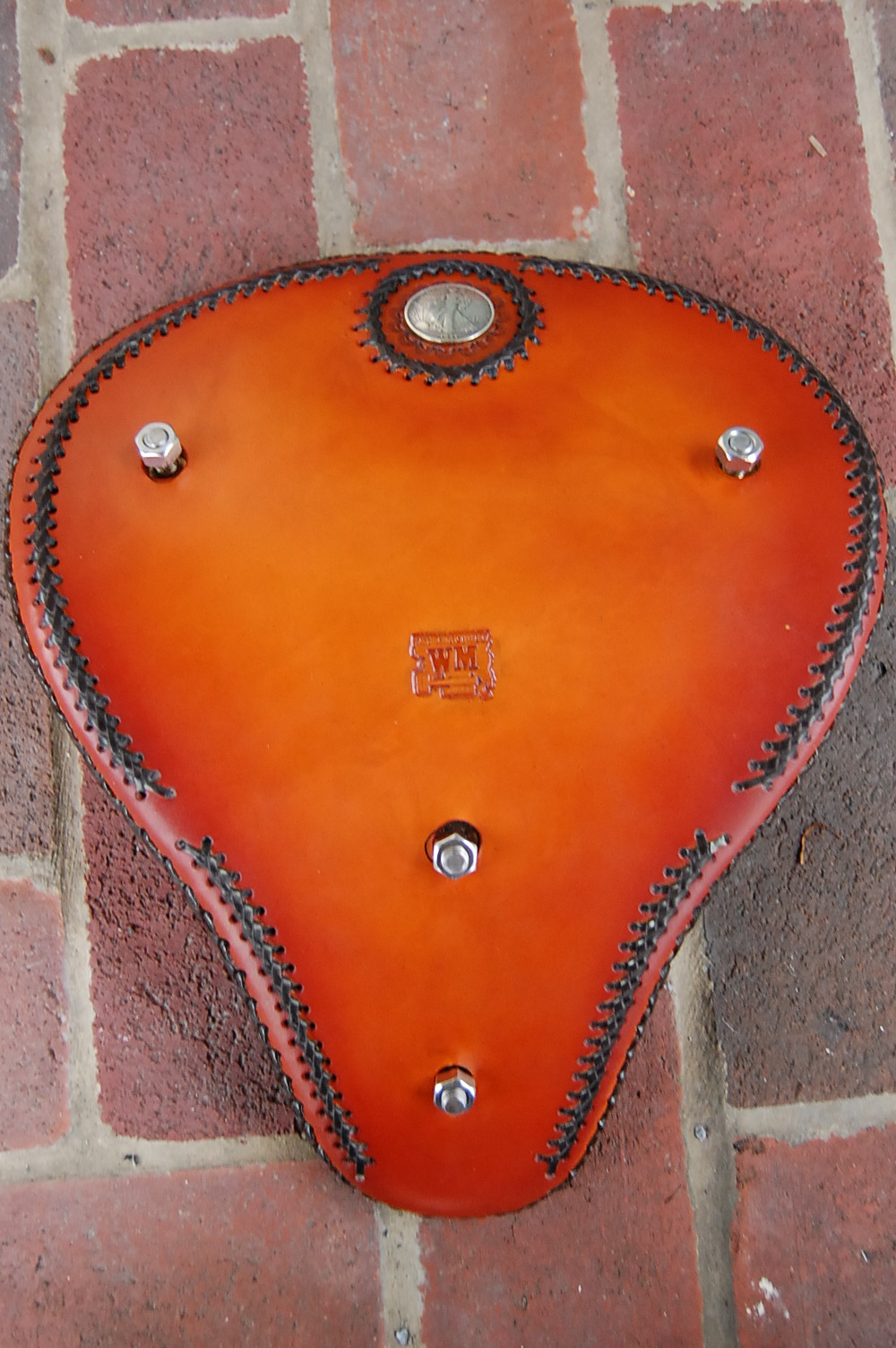

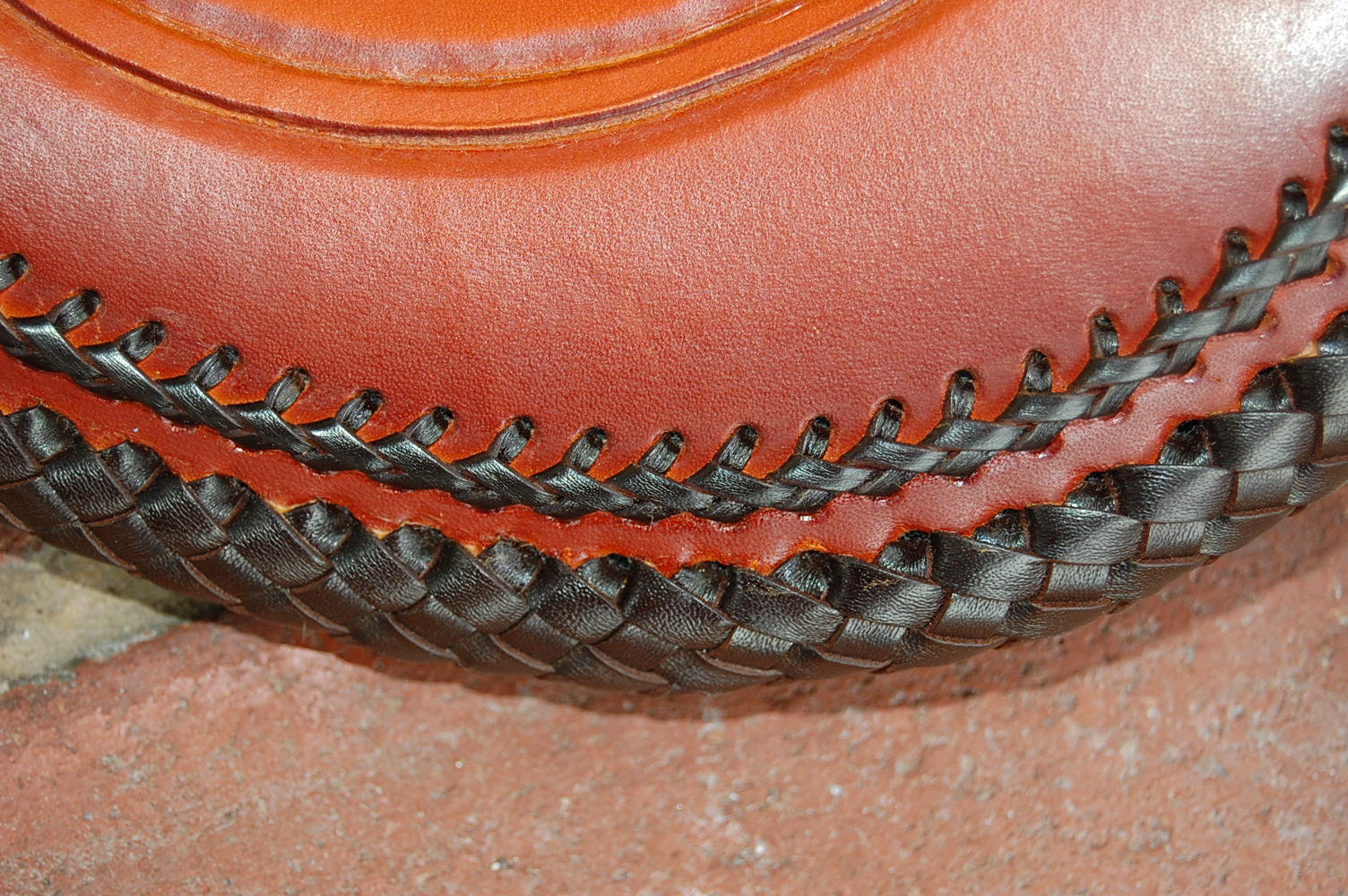

Here's some more with the back, these ones show the color more accurately than the others. There's a few mistakes in it that are quite obvious.
