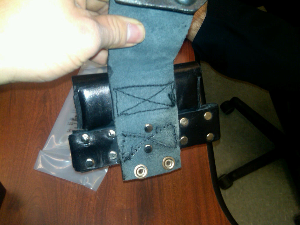

Setting Rivits Without Access To Both Sides?
billymac814 replied to billymac814's topic in How Do I Do That?
Thanks, that's pretty much what I was figuring, I was hoping maybe I was overlooking an easier way of doing it. I don't think there is a way to attach them all before it's put together, not all of them anyway. -
I need to make a pouch that matches another one that was made by someone else and there are rivits that hold it together in the back, I'm not exactly sure how to set the rivits since the inside is quite small and deep, my thought was to cut a piece of hard wood that fits inside and hopefully be able to set the rivits against it, but I'm not sure if that's the easiest way of doing it, I might be overlooking some simple solution too so I figured I'd run it by everyone. I didn't make this pouch but this is what I mean, the rivits on the bottom pouch are the ones I need to set. I want to match the design of this one but do it in a higher quality finished product.
