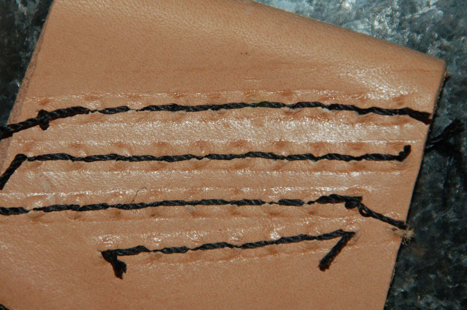

  3. Twin oaks you have been a big help, the other post was helpful. If i can ask you one more question. I have the bottom tesion as tight as it gets and the stiches are looking good,if i loosen up on the bottom tension do i tighten or loosen the top tension?
  4. Thank you Twin oaks. I checked the things you suggested and all was well, i tried makeing the adjustments there was no change. Here are a couple of pics that i hope help.
  5. Some how my machine got out of correct tension. My stiches are to tight on the top leaving roll ball like thread spots on the bottom of the project. I have tried what the manual says and nothing is workng. I have been at it for over an hour, what is the problem????
