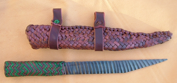

  13. Hi Flatlander - your braided knots look great, I always remember feeling that I was finally getting it the first time I managed interweaves like yours. heres another knife pouch I have just done for a viking saexe blade - It is made from a wide flat braid folded over, this first attempt is not perfect but it's getting there. First off I thing doing a under 1 over 1 braid instaead of 2o, 2u will make the braid wider which it could of been at the end to accomodate the handle of the blade.

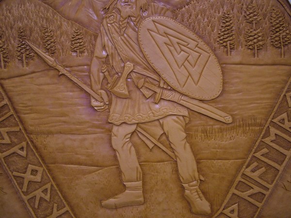

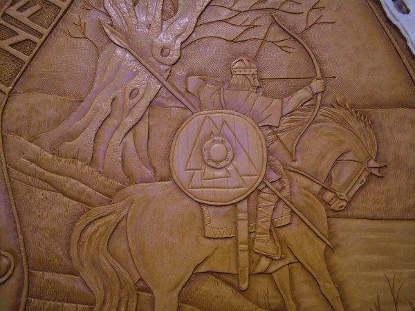

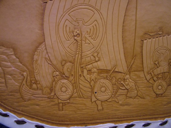

  24. Cheers for every bodies comments. have had to check just how long I have been doing this stuff and it was about four years ago after a visit to standing bears trading post in los angeles - amasing how time flies - it was a few months after that I went to BC canada to learn the western saddle stuff. Have attached some close up's of the shield. I have tried to do a variety of things - just my way I guess - before doing this I made bows, and my own arrows, quivers etc - even made my own rawhide for backing the bows with, too old for that malarky now, just happy with the whips, knives and the occasional saddle or carving.
  25. Not the clearest of pictures, but this was one of those labours of love and seemed to be in the planning stage for a few months too long, but finally got round to doing it over xmas.
