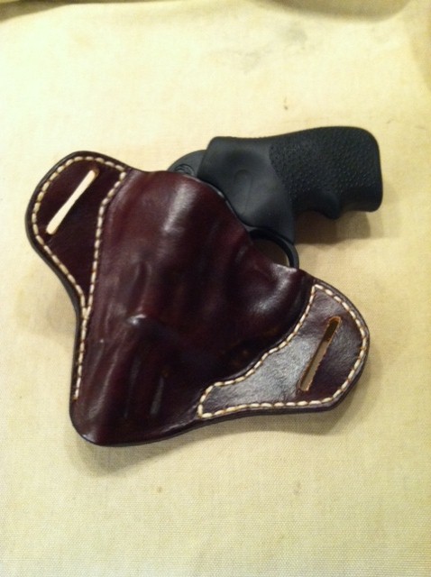

Thanks Rayban, I appreciate the compliments! You're right about the retention, it worked out nicely. I was concerned at first because the gun did not fit as snugly as I prefer when the holster was not on a belt. When I wet molded the holster, I did not want to form too much above the cylinder because I did not want the gun to hang up when being drawn. Later I realized that once the holster was actually worn, the belt assisted with retention and the gun fit perfectly. I am about to use the same pattern to make a holster for a S&W 642 J frame. I think everything will fit the same-hope to post pics soon. Thanks again! -

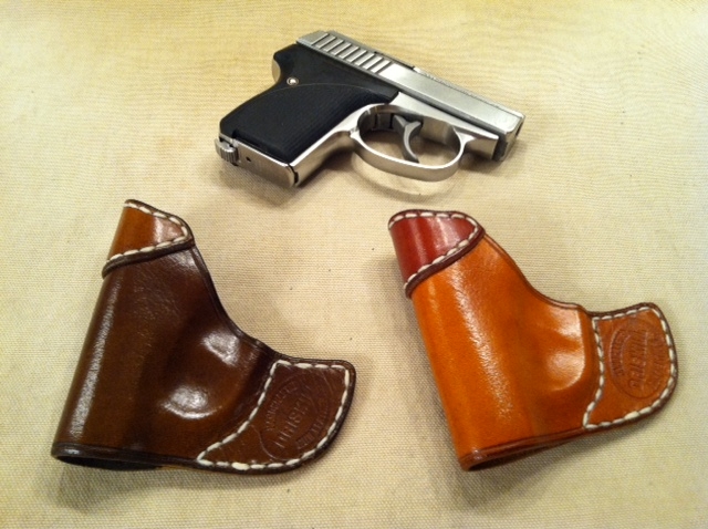

Just finished these two holsters for a Seecamp 32 auto. Also included are pics of two recent badge holder orders. Please let me know what you think! Thanks!
That is a good looking holster! How do you keep your tooling from becoming distorted when you wet and fold the holster during assembly? Also, if you don't mind, what products do you use to dye/finish?

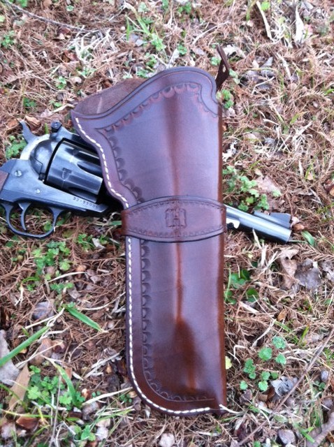

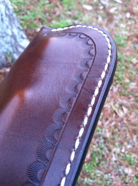

Thanks for the compliments! I know the flesh side could have used more attention, but I'm still in the learning process as far as that goes. I did edge both sides prior to assembly, but by the time it was finished, the "fuzzies" were back. I also agree that it should be open on the end and I will do that on the next one. I had to make this pattern myself, but I used Al Stohlman's pattern for a Ruger Single Six as a guideline. I also think that I may stay away from the clear-lac next time. It seems like it provides a good protective finish, but the results are more glossy/plastic looking than I prefer. Has anyone had any experience with tan-kote or bag-kote? I wonder how it would work out if I used dye, neatsfoot oil, bag-kote, followed by a coat of neutral shoe polish? -
Just finished this holster for a Ruger .357 Magnum Blackhawk. This is only the second western style holster I've attempted, so comments and suggestions are welcome. This holster is made from 9/10 oz. veg tan leather, unlined. It is hand stitched and burnished. Finish consists of Fiebing's dark brown spirit dye, neatsfoot oil, clear-lac, resolene, and a coat of neutral shoe polish. Please let me know what you think!
