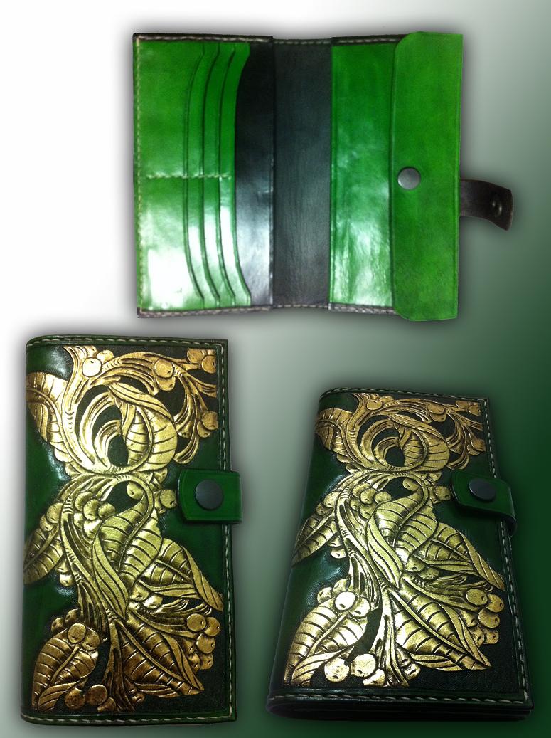

Green Gilded Wallet
Bifrost replied to Bifrost's topic in Purses, Wallets, Belts and Miscellaneous Pocket Items
I used gold leaf(brass) and not paint. And yes, it will crack a little bit when it's being used, but not so much I think. Below are the steps I used to prevent it from cracking and oxidizing (since I used brass and not gold it will oxidize) aswell as giving it an antique look. 1. Applied the brass 2. Waited 48 hours and then applied something here in Sweden called "Zaponlack", it's used to prevent metals from oxidizing. I guess almost any top coat that prevents metals from oxidizing will do. But I have noticed that if you apply this before 48 hours the top coat itself will crack the gold. 3. Waited 1 hour for the "Zaponlack" to dry completely and thenapplied antique 4. And finally i used super sheen to seal the antique. Kind regards Tommy -
Hi! This is a wallet I made. I have tried gilding before but it has alwayes turned out to glossy. But this time I applied som antique on the gilded areas and I think it turned out nice.

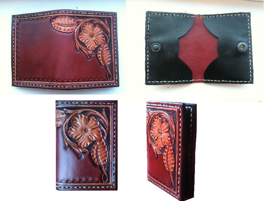

Card Holder
Thanks Ken. Yes, the pockets are to deep. I will fix that on the next one I make -
Hi! A simple card holder I made some time ago. I'm pleased with the carving but I think I need to work more with the inside of the card holder. Kind regards Tommy
