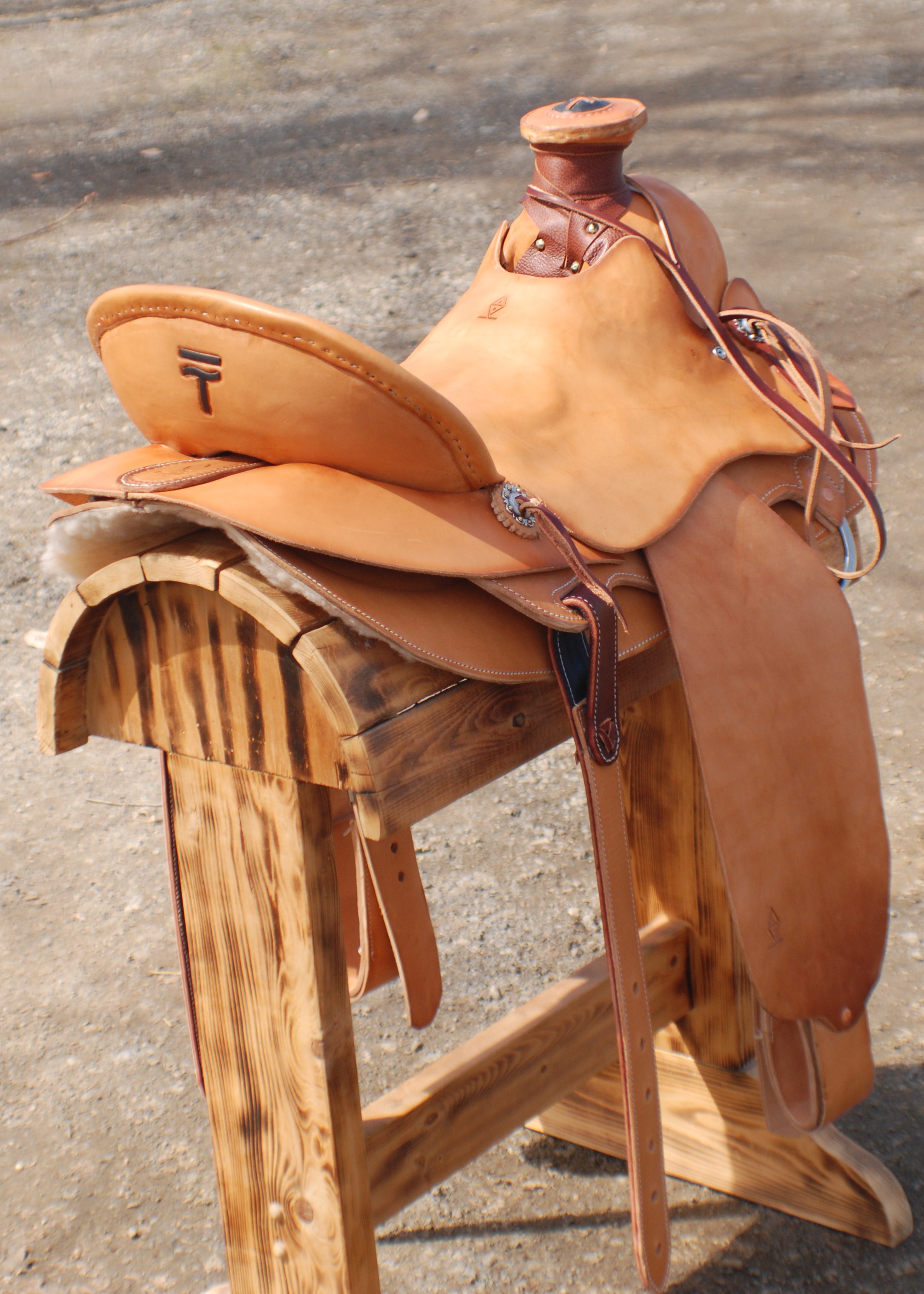

  4. The customer really likes it If you can see the horn in this picture i filled under it so the leather looks like a horn cap concho but its all leather
  5. Just finished this Wade for a customer. i was sure how it would look since its not tooled much but it turned out nicer than i expected.
