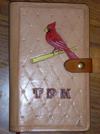

  8. Made these for some of my coworkers
