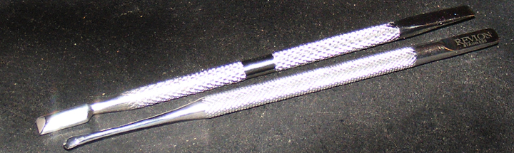

  2. Often overlooked source. Walgreens. Look in the nail care department for cuticle tools. Different brands use different profiles but all I've seen so far are SS. Save money over the Tandy variety as well. And of course you can reshape some to your favorite profiles.
