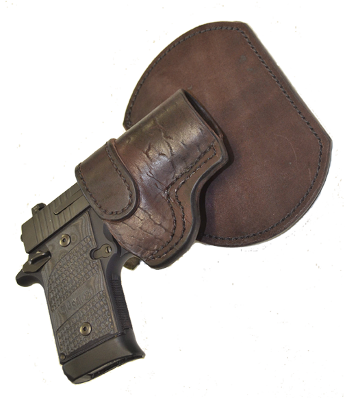

I've made quite a few paddle holsters. In fact,they're one of my most popular models. My thoughts, for what they are worth.... -- Paddle holsters are best for small, lightweight guns, like, PPKs, J-frames, P938s, etc. -- Ultimately, it's not the paddle that supports the gun, but the waistband. -- My paddles are made out of kydex covered in leather. While the kydex backbone provides stiffness, the leather "ears" are flexible enough that they conform to the hips and keep the holster from sliding out of the waistband. -- Properly made, a paddle holster for a lightweight gun does not require a belt for support, but it does require a decent waistand. -- Within the pantheon of concealment holsters, paddles are the ultimate in convenience. tk
