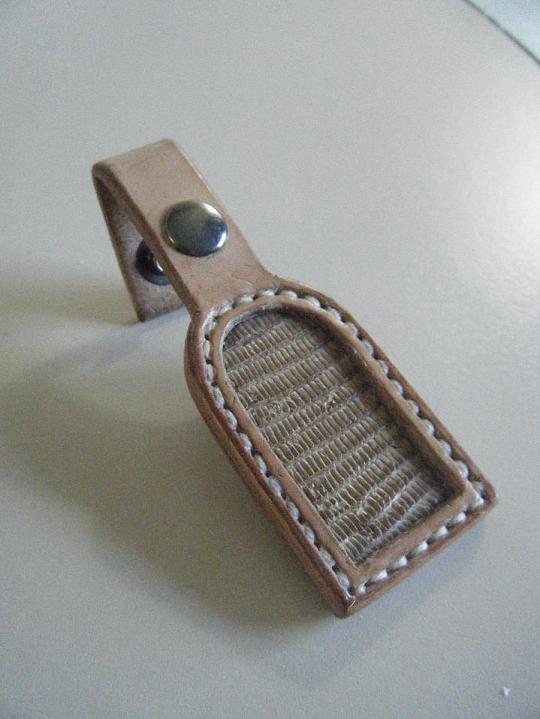

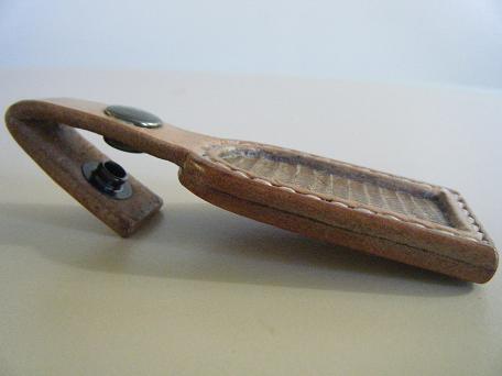

So, I've been on a business trip in Auburn Maine for the last 10 days. Before I fly up here I packed a few small pieces of leather and some basic tools knowing that I would need something to keep me occupied while at the hotel. The pics are of a barrel/toe rest for use while shooting clay target type sports. The leather is from a 8-9oz low grade tooling side with a piece of lizard skin on the inside. Actually I only think it's lizard as it was part of a grab bag I purchased from Springfield Leather and none of the pieces where labeled. I sanded the edges with 150, 180, 220, 400, 600, 800 & 1500 sand paper then finished with the saddle soap and canvas method. I then sealed the entire piece with Fiebings Bag Kote. And finally I put on a coat of melted soy wax then buffed when dry. Nothing special here folks just wanted to share. The leather wasn't in the best shape to start but I'm happy with the results. The best part is I'll get a chance to use the barrel rest this weekend when I attend a sporting clays shoot in Rhode Island before flying home to Tulsa.
