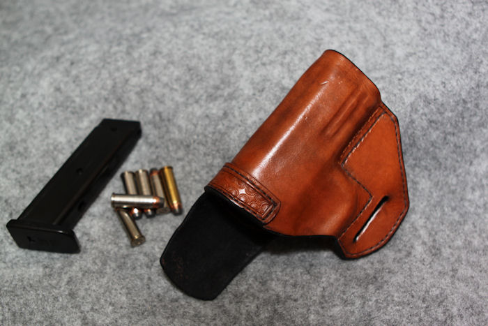

My First Avenger Holster
mlapaglia replied to mlapaglia's topic in Gun Holsters, Rifle Slings and Knife Sheathes
Mike, I had a short talk with my kid about that since he took the photos for me. It's actually .357 ammo from the speed loader of my Model 27 S&W and the clip is from his H&K USP 9 Airsoft. He was going for "art" and we had a talk about accuracy vs "art". Those pics will never be seen except here. I wondered who would catch that. Thanks for the comment. Michael -

Gentlemen, I totally agree about the stitch line right angle. I know better but had what in my family we call a brain fart. I made several first timer mistakes on this one. The main thing I learned is not to do leather work when I cant devote all my attention to it. Thank you all for the comments and suggestions. It helps to get feedback. Nick, I did a stitch gouge line on the front of the holster but did not do one on the back side. It was an economy piece of shoulder from Tandy so the inside was a little rougher than I like. I shaved it down but it still looked less than great so I figured the black would hide the defects on the inside of the leather. I do like the way it came out. Im not sure it will look good with a darker outside color but I like your suggestion of it being a signature element. Thanks. Dwight, Ill give dip dying a try. I just need to stock more dye than a 4 oz bottle in order to try it. Markush, Thanks for the comment. I have been fighting sharp corners since I started. Im getting better but still need to keep an eye on the angles. Mattsh, Ive seen the preval sprayer but never knew how long it would last. Thanks for the estimate I'll give it a try. Since I normally use stain I will probably have to thin it out some. Its pretty thick compared to dye. -
Ok, I did 2 pancake holsters so it was time for an Avenger. I have to say that for me I like the avenger better than a pancake. Its 8/9oz shoulder. Brown 4ply linen cord. Eco-flo Briar Brown stain with Fiebings USMC black on the inside. EVOO after molding. Leather Balm w/ Atom wax as the first finish. I want to try the mop and glo but have to buy some first. I looked at the 3 part "How to make a leather holster" video by particle about 20 times and wore out the printed copy of Holster Design (long) by mattsh. Then grabbed some paper and started drawing. 3 days later I threw it all away and started over this time remembering what I had learned in the two tutorials. It went together pretty well. I forgot to burnish the reinforcement piece and the initial stitch line for the barrel was way too close. So close in fact that I could not get the barrel in to the part of the holster where it should go. So I stitched another one farther away and then pulled the stitches for the first line. You should not have any problem seeing the original set of holes. I also wasn't paying attention when I did the edging. I went ahead and edged the inside of the sections that were supposed to be glued together. Makes sanding and burnishing a lot of fun. Dyed it after it was cut out. I still need to learn how to not get streaks. I cant afford an airbrush yet so I may just have to wait. I did bake it for 20 minutes at 125 and it got nice and firm. First time it really worked for me. I think it wasnt as damp as the last time I tried it. Removing saddle stitches is not easy when you are trying to not damage the leather. Any way, the new stitch line let me get the gun in the holster and do the molding. I went with minimum boning. I think I like the avenger this way. Considering the mistakes I made I'm happy with how it turned out. Please feel free to let me know what you like and what you think needs to be corrected or improved. With the exception of the first picture all the others were shot by my son the professional photographer. Figured the kid could use the advertising. Let er rip guys.
