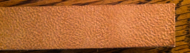

I tried the rolling pin and it was not as deep or as textured as using my poly hammer. It wasnt a problem to hammer it out. Even on a bigger piece. Good idea. Maybe someone with better upper arm strength could make the rolling pin work. Tony, what is "fly wire"? I am not familiar with that term. Michael -
I got a new poly board to do my hole punches and chisel work on. I was using a single diamond chisel to put some stitching holes in a triple layer of 6/7 veg tan. I had to flip it over, grain side down, to finish a hole that was stubborn. When I turned it back I had a pebble texture around the hole. I had failed to pay attention to the fact that the new poly board had a pebble finish. I used a modelling spoon to fix the sheath but it gave me an idea. I took a scrap of cased 6/7 and placed it grain side down on the board. I tapped the full length of the leather with my hammer and was treated to a very nice textured surface. I plan to use this for a Belt I am doing where the person wanted it textured and I didn't really want to use a stamp on the whole surface. It will sure be a lot faster. I'll sand the other side of the poly board for normal work but it was an interesting discovery.
