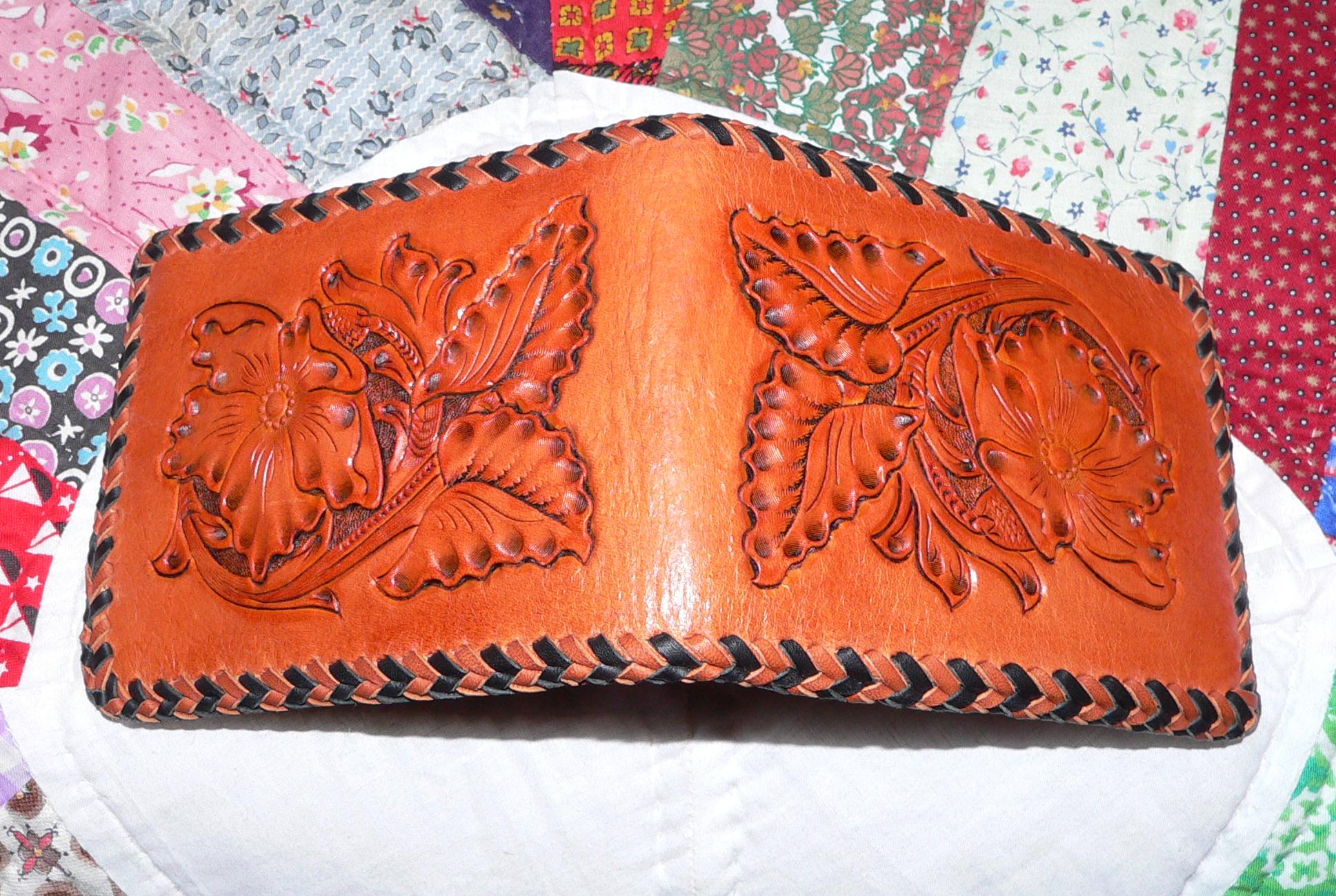

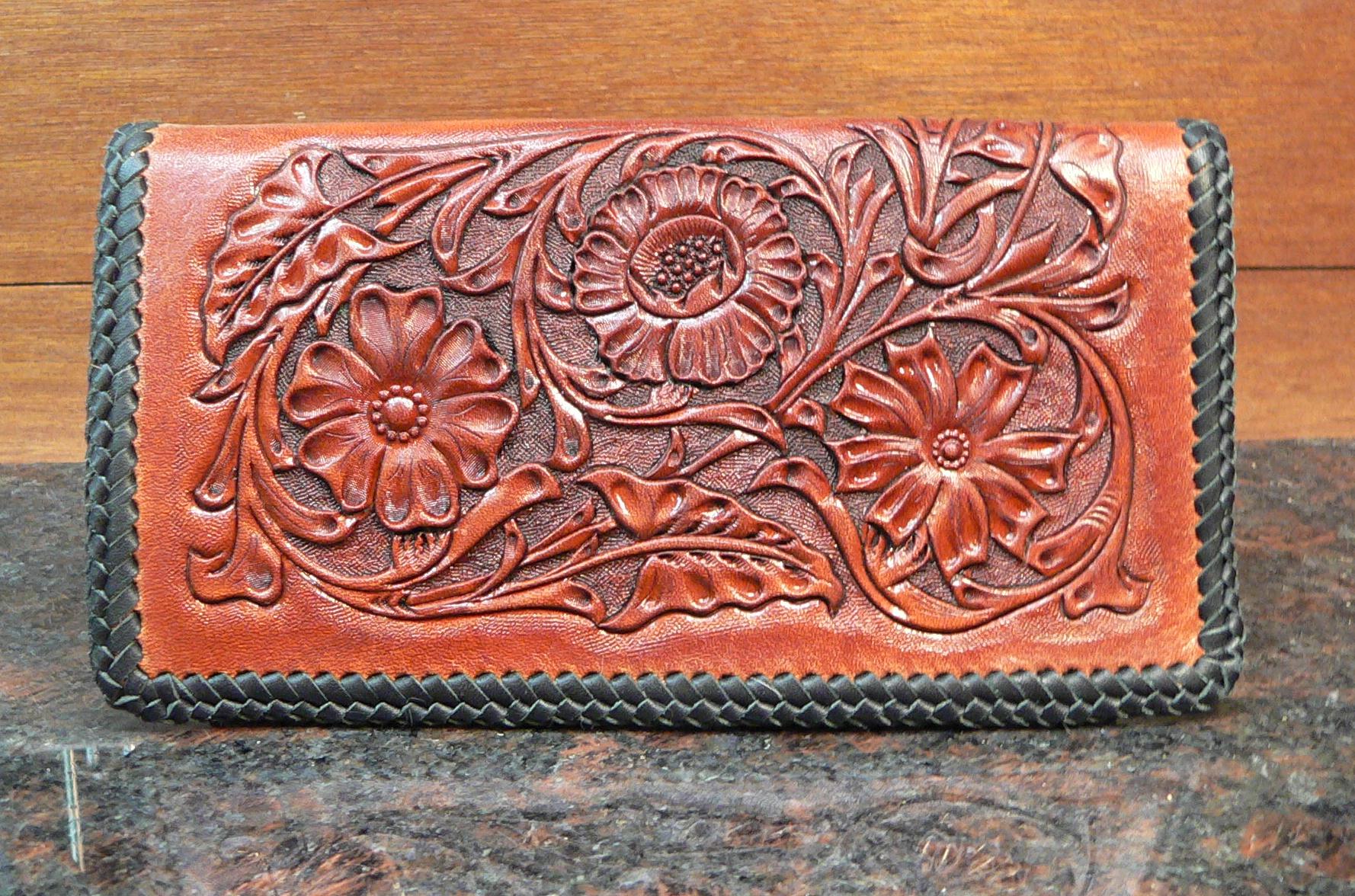

Oil Dyed Leather Won't Get The Correct Color
electrathon replied to lokeland's topic in How Do I Do That?
Forgot to add, all of these are dip dyed. This one was done in british tan, diluted 50/50. Always practice on a sample and let it dry if you are going to be picky about the shade. -
It does work, once you get the hang of it. The holster is 2/3 Ox Blood and 1/3 black. It is dark, but not black. The Bible cover is brown (not sure what one), diluted with alcohol.I don't remember what color I used on the Checkbook, but likly was the same as I used on the Bible cover. Aaron -

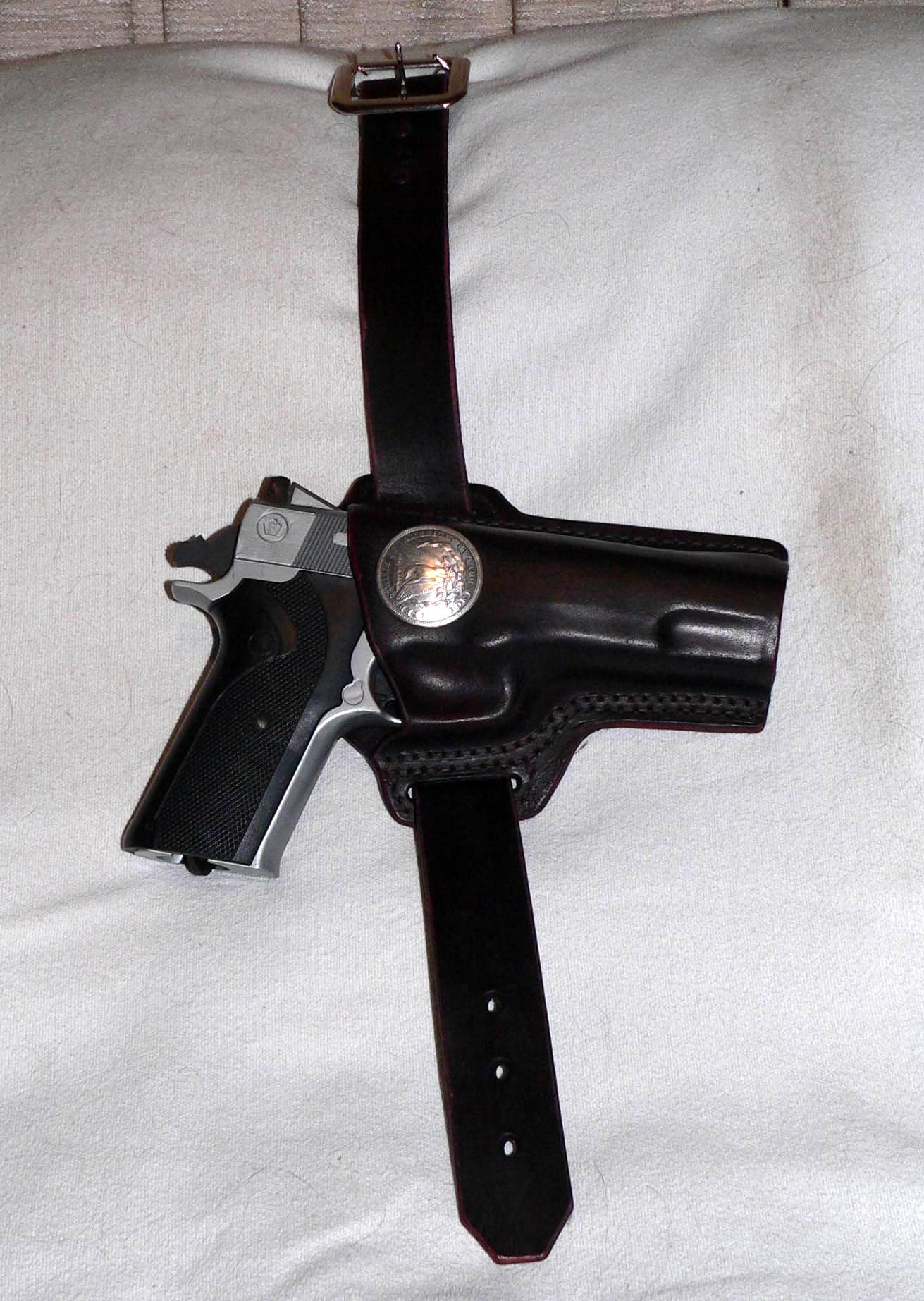

Demo For A Class
electrathon replied to electrathon's topic in Gun Holsters, Rifle Slings and Knife Sheathes
My plan is to have a few started at differant stages so I can jump forward, not spending time on things like sewing and drying. I am hoping to have it similar to a cooking show where they mix something up, slide it in the oven and then pull out the finished cooking dish. Sort of like the Galloping Gormet, just with gun leather. Aaron -
Next month I am going to teach a basic how to get started class on holsters. This design seemed to be very basic and relitively easy to explain. If this works out well I hope to move to a few differant styles down the road. Aaron
