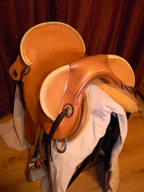

Thanks Knut. Yes it is. Sorry I didn't give any info on it. 15.5" Laporte,cable rigged,Hermann Oak. I want small and light for a game I play on horseback called Polocrosse. Small skirts with less insulation and more air flow. "balance ride" style forward located stirrups. I wanted more of an Australian saddle ride to it. The stirrups hang about 3" forward than if hung over the tree. I have a friends Aussie style saddle that was built 30 or so years ago by Brock Lynch with this setup and I really like it for what I am doing on horses.
I've not built a saddle since last May. With work being so slow I got back in the basement and made myself a saddle for Polocrosse. This is my third completed saddle. First one unsupervised. It is similar to last two I posted, but I tweeked the design some.

You can use the lock rings they will provide you with the tree to set the location of the latigo and off billet. Or you can make an adjuster out of 1/2" nylon webbing to go to the back side of the latigo on the cable and pull the cable forward to a buckle to form the "u" shape into a "p" shape. I conceal the buckle under the latigo and cinch keepers. In the "P" the latigo can not slide uphill on the cable to change locations. Without the lock ring or nylon it will settle in to around a center fire. I will see if I have pics. I do not use the lock rings. I like these trees. They are predictable,consistent,accurate,LIGHT, water and moisture proof,semi rigid with some flex, easily shaped to custom fit... I like them. I have two Aussie trees on order and should be here at the end of the week. If I don't have any pics I will take some during construction.

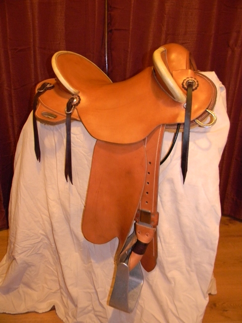

Just finished another Aussie hybrid. This one is a 16" cable rigged,rough out on semi quarter horse bars with Jeremiah watt conchos.

Saddle weighs 24 lbs. with the aluminum stirrups. Its being ridden in the Kenlyn Urban challenge in Denver this weekend. I will be making an endurance version soon and hope to get the weight down even more. This one is my Polocrosse saddle.
Thanks for the kind words. Yes it was fun. More than fun. I am starting on #2 this week. I will post progress pics of that one if anyone is interested. The saddle will be tested on Saturday in a 25 mile endurance race in Denver.
Aussie hybrid. Built on a Laporte Stockman tree with semi quarter horse bars and cable rigged. I play Polocrosse and wanted a better fitting saddle.
