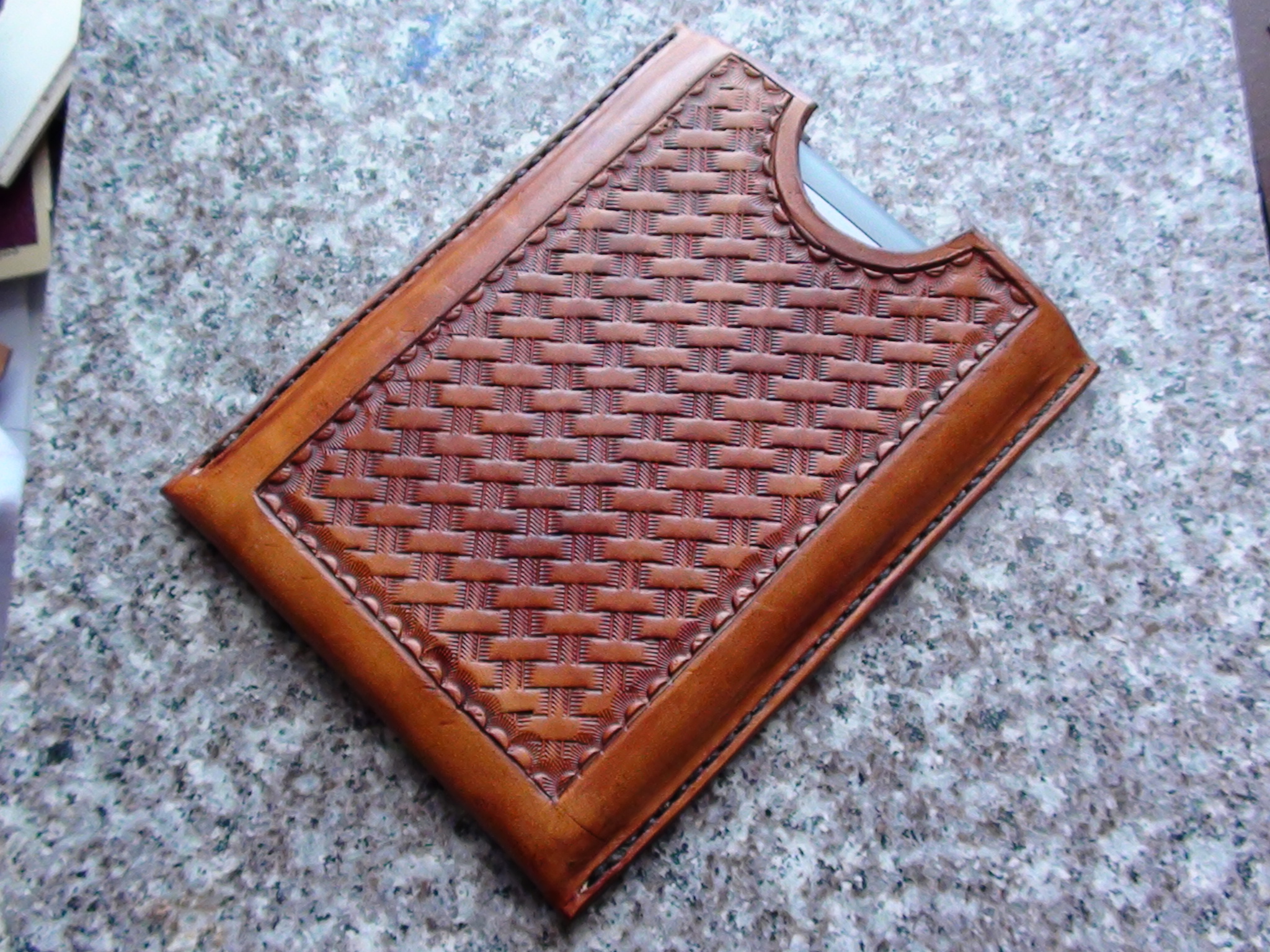

Second Kindle Cover/case
Tzalabak replied to Tzalabak's topic in Purses, Wallets, Belts and Miscellaneous Pocket Items
Thank you. On the first I made (and am keeping for myself), my stamping wasn't nearly as good. I was specifically trying to see how quickly I could tool the whole thing, so the basketweave tends to bend and sway a bit. I took more time on this one to improve the quality of the weave. Ended up pretty pleased with it. Still a little sway, but I think that's mostly because I didn't get QUITE the exact angle I needed on the first couple of rows. -
Just finished my second Kindle case. The first one I made for myself, this one I might try to sell. I'm pretty pleased with how it turned out. There are a few issues with it, but overall, I like this one. Accidentally pulled the thread too tightly at the bottom of one stitching run and ended up cutting right through the lowest hole, hehe. It's not too noticeable though. Any feedback or criticism?
I don't quibble over little things. It's the things that occurred during the learning process that irked me, hehe. Things like being left handed, using a righty stitching groover, and over-powering down a line and shooting off the end of the piece. Having some snaps set so poorly that the piece doesn't come together right, but I can't really remove the snap for fear of messing up the piece. Things like that. I'm not going to get upset over a slightly off stitch line or a belt loop that isn't perfectly aligned, hehe. My bigger mistakes (but stuff that's still salvageable) usually becomes my personal case or whatever until I make myself something better, heh.
I had thought about that beforehand, but decided that with the side curve from the molding, that it would hold well enough in the long term. It seems like it won't become an issue. As it stands, it takes some pretty vigorous shaking for it to come loose, so I think that even if it loosens a little bit, it will still hold well enough to prevent any accidental dislodging.
