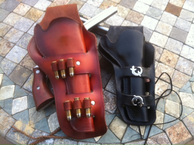

The Twins
renegadelizard replied to renegadelizard's topic in Gun Holsters, Rifle Slings and Knife Sheathes
Its a single 10...i was shopping for a single six last year and when i looked down in the display case, there was a single six that had a few hard years on it, and for a few dollars more, there was this brand spanking new single 10...last year was the first year they came out with them, so i figured I would grab it up and if they didnt catch on, then i would have a rare safe queen...im glad i got it, it is a tack driver...the other is a ruger redhawk with an absurdly long barrel...my buddy deer hunts with it and asked if i could make him something cool to hold it in, and in my estimation, a doulble loop rig is about as cool as they come.. -

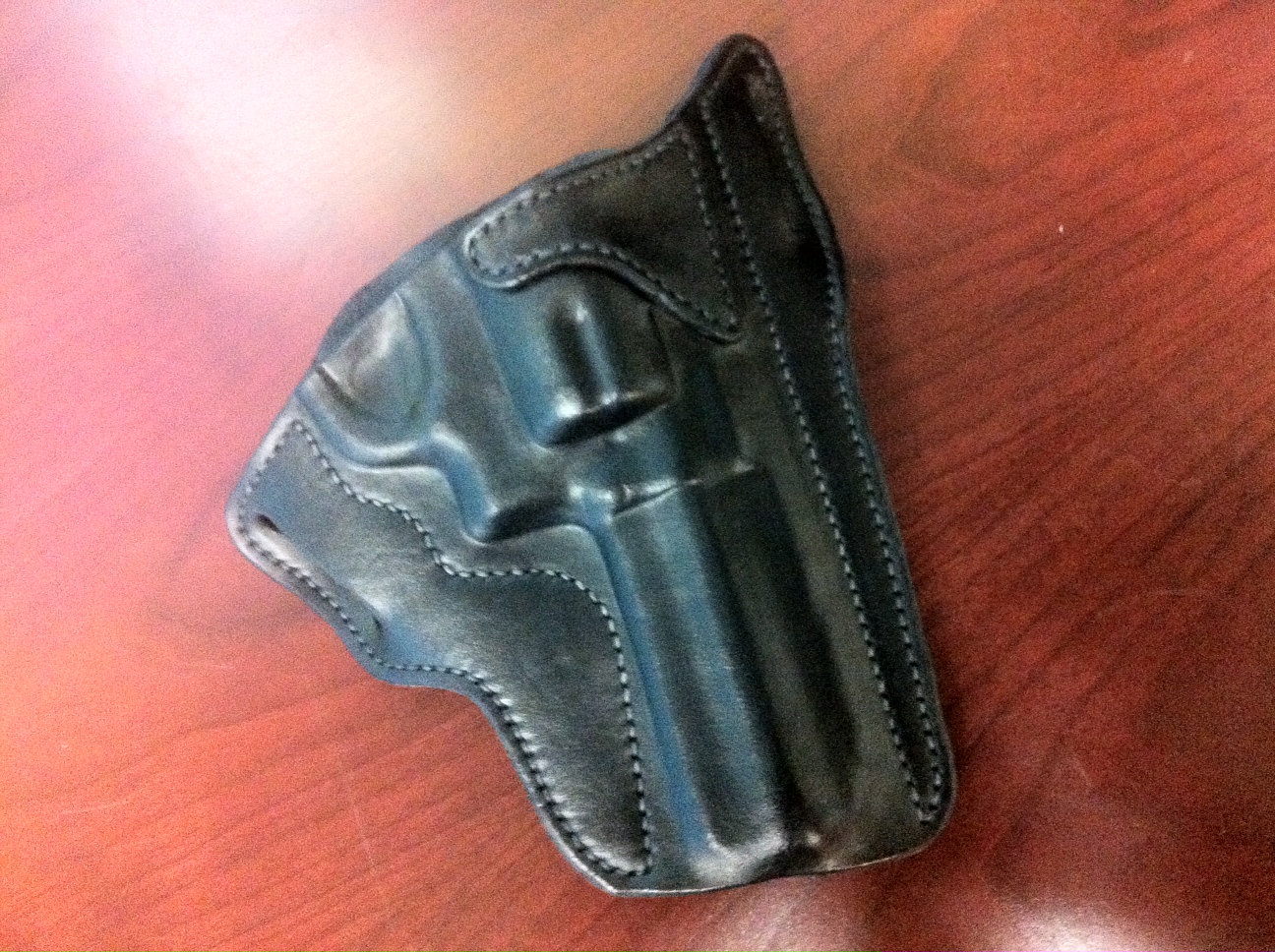

Thanks Particle...praise coming from you is indeed highly appreciated..i just watched a couple of your video's and am amazed with your work....the customer wanted this to be a simple range holster. Ive been an LEO for 18 years, so I figured, what makes a good range holster.., ease of draw and reholstering, easy on and off, all day comfort, and sex appeal...we all love flash, but clean lines and business built say so much more than rhinestones...the customer is also female, and it is her first custom holster, so ride height and cant was an isssue because she simple had no idea what would be comfortable...(this led to me wearing my pants low on my hip, walking about the house trying to figure it all out..so not a good look for me) ...so i cut the leather at the top of the cylinder and slightly flared it out, for spedy draws and reholstering...i spent alot of time in the trigger guard area, and before I dyded it, it would snap in...after dying it lost the snap, but still holds well enough when belted up...I need to get a pear shaped shading tool to really get the leather down in there...i tried to cut a stich groove on the inside of the reinforcement piece with my freehander, but i think all i accomplished was pressing a slight channel in the leather..my freehand groover is ground a little funky and not very sharp yet..still trying to figure that one out...I stiched the front seam and left the back open sort of hand pinched the leather all around to figure out the back stich line..then transfered that to my pattern (saw your tip on correcting your pattern) ..all in all, im pleased with it..i still need to be more careful with my tools..and I agree..revolvers are a bear to do other than the western rigs...next up is another avenger style for a glock...hopefully it will turn out better than my last one...thanks again for all the tips and tricks you post on here...it is greatly apriciated.. Don
