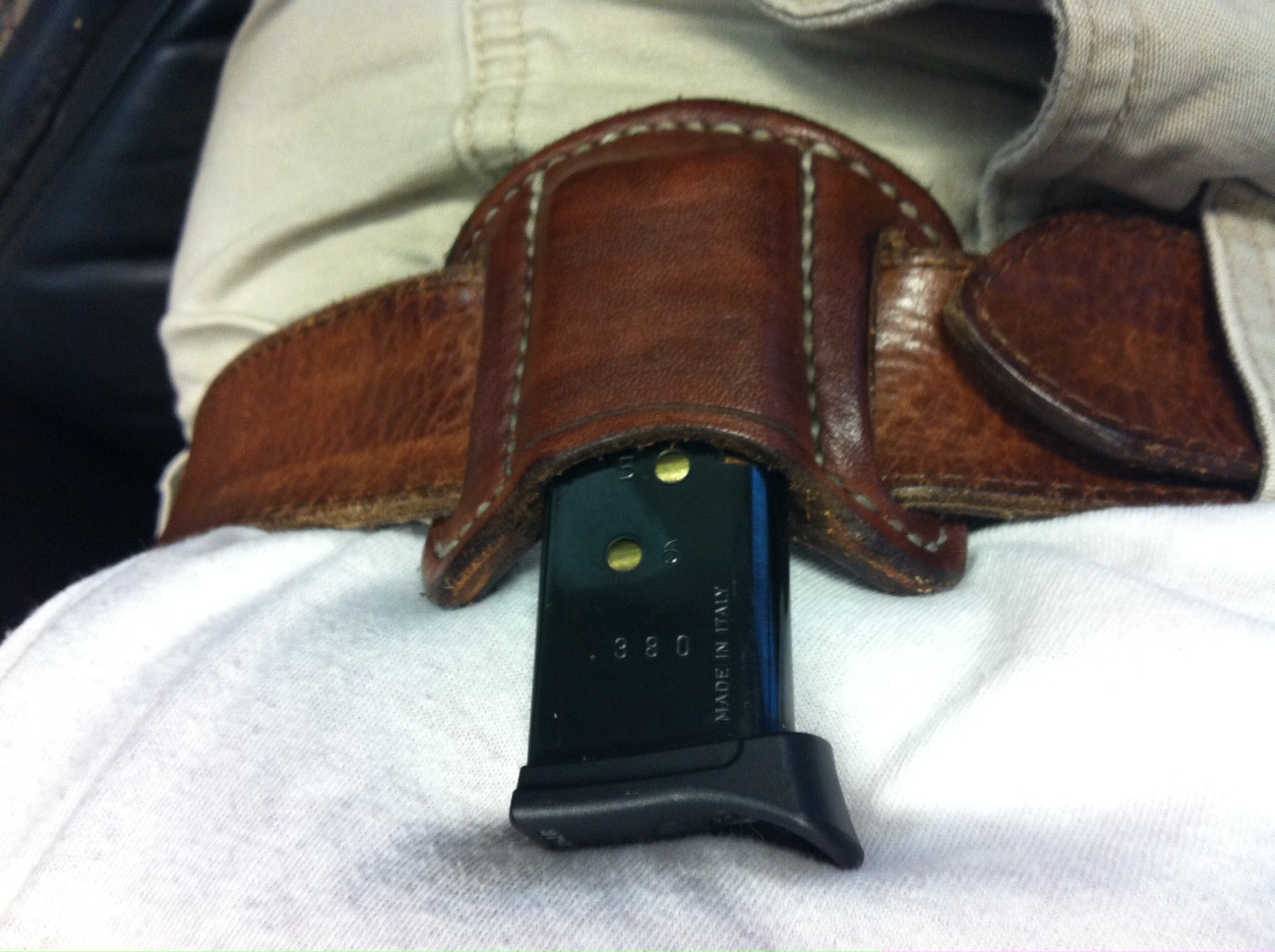

Hey Eric...Ive been toting a gun on the job for 18 years this year, and i have had the opportunty to carry lots of different mag holders...the pancake style is, in my opinion the best...the fold over snap on ones sag out after a while and get caught on everything...the belt channel ones sag out after a while as well...for less bulk on your doubles..shrink your negative space in the middle and move your stitch lines in as close as possible..you will have to work to get the mags in when wet forming but it will be smaller by far...i did an inside the pocket mag holder for a sig 239 in 357 sig..i got two mags, side by side to fit in pocket with room to spare...ill try to find a pic of some of my "no boundaries" mag pouches so you can get a better idea what im talking about...now, i wouldnt stop offering the ones you make now..they are incredibly awesome looking mag pouches...i would just offer ALW "lite" mag pouches as an alternative...
