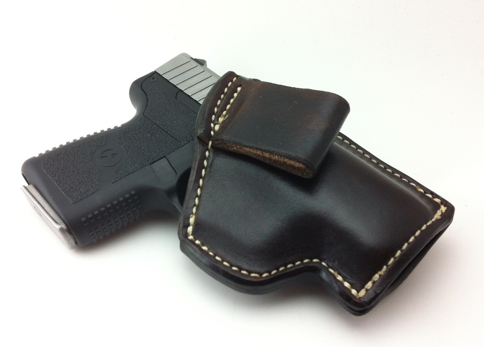

Hey All, I spend alot of time doing inside out IWB's, so when i get a chance to do something other than that i get all giddy...here are a few recent ones..critisism welcome...

Looking good..the only thing that stands out to me is the stitch length..looks a little too long...if you dont have an overstitch wheel to mark the leather for 6 stitches per inch, use a ruler and mark your pattern every 4 mm..thats 6 spi..transfer your marks to the leather with a scratch awl or something else sharp and pointy and you have your stitchline all laid out...this is also a really good technique for doing western style holsers and pouch type holsters where you dont have a lot of room to get a good glue bond..
