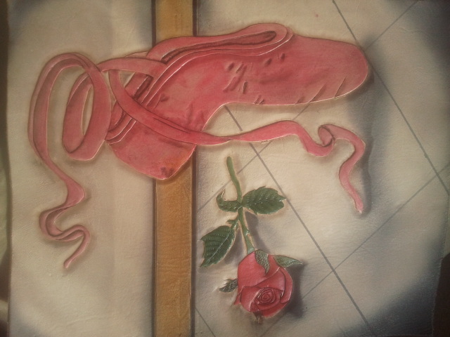

A commissioned carving for a friend still needs finished edges and coat of resoline.

Last pics could see whats going on to me it dosnt look like you are beveling your carving that would help make it pop and give it dimension. I havnt done a seat yet been focusing on the carving buthave a couple coming up this winter
