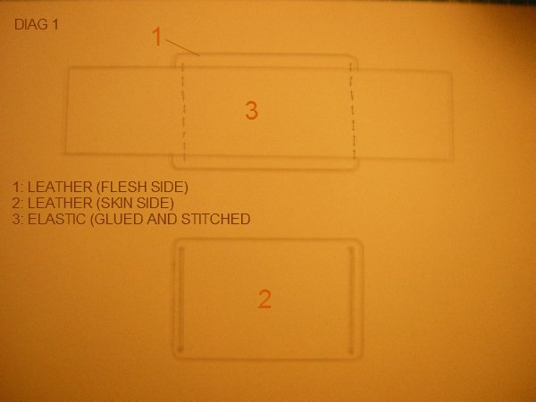

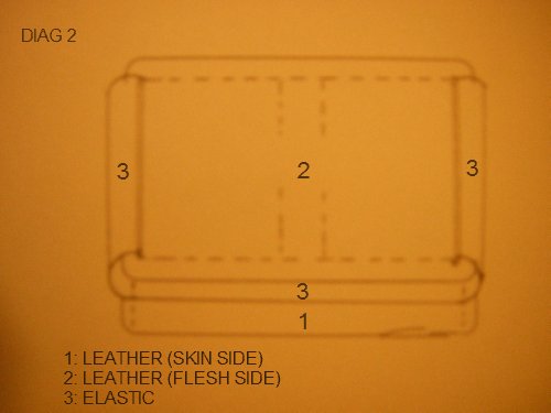

Okay, for the benefit of those who haven't given up on me... :D I thought it only right to tie up this thread and say I've finally decided how I'm going to do it. I was having a good mess around with cardboard templates/prototypes and came up with this: Diag 1: Two pieces of leather, cut to size as before. Then I take a length of elastic (long enough to wrap around the length of a credit card with a slight lap over where they meet again. I then lay and glue this elastic, centrally, on the flesh side of one piece of leather with some stretch glue, and run a stitch up either side, thus securing the elastic in place. Diag 2: I then take the other piece of leather and cut a slot from top to bottom at either end. Then feed the loose ends of the elastic around the edge and back through the slots on either end (so that the elastic is now on the inside again (indicated by the dashed line)). Glue the ends together. Done. Please note, I have the flesh side and skin side the wrong way round in diag 2.
