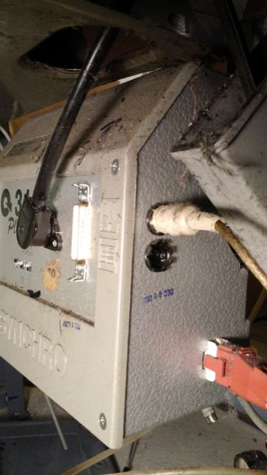

Uwe, I have added two pictures of the power cord. One is of the end with the plug taken apart and the other picture is of the end that goes into the box. The brown, green and blue wires that my index finger is on are the only wires that make up the cord. I have also been talking to my uncle who used to be an electrician and he said if the motor says it is single phase, then that is what he believes it is. And I have not had any success in finding manuals for the control box.

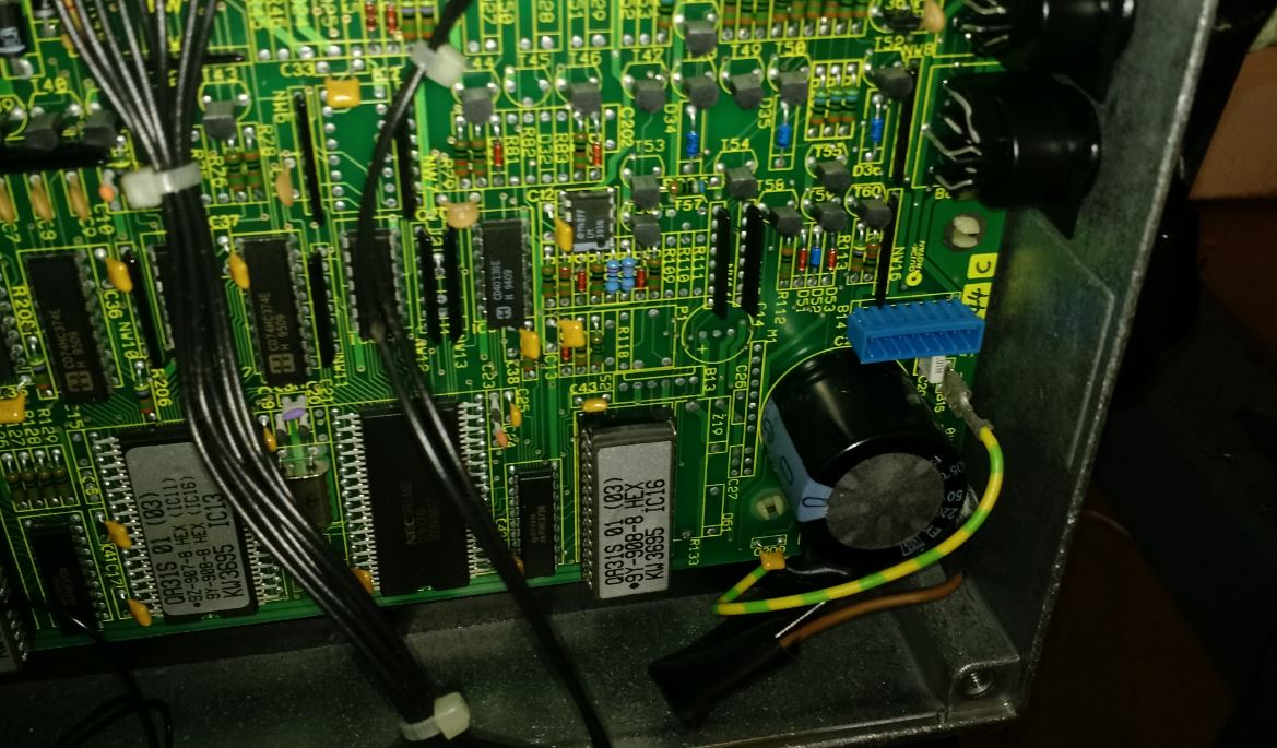

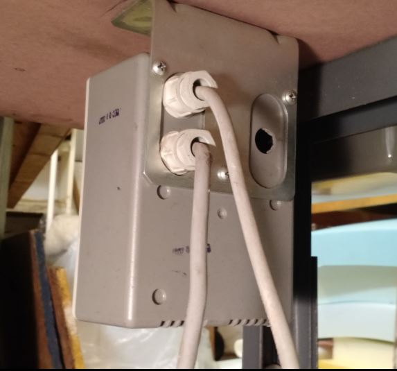

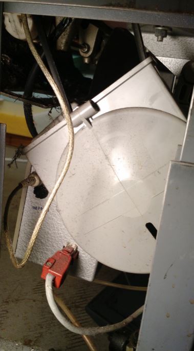

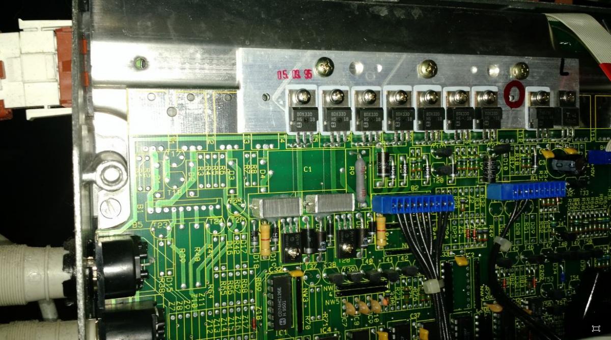

Tinker Taylor - yes that is a crack. Uwe - I have attached pictures of the box with the power switch, I also opened it up and took pics. I have also added pictures of the control box and motor. I even took off the cover of the control box and took pics. The only other sticker I found was on the box with the power switch so I have added a pic of that too. SARK9 - I have never owned a sewing machine before and I did not expect to get one with all of these features. No I do not need all of the features so even if I removed them but kept the pneumatic ones wouldn't that be ineffective because it all runs off the control box? Constabulary - As far as I know, I have no use for all of these extra features, I am really understanding why Uwe said "for the novice leather sewing hobbyist it may be more of a setup and maintenance headache". Switching everything back to manual and getting a different servo motor is sounding very ideal. KenG - That is what I am really considering doing.

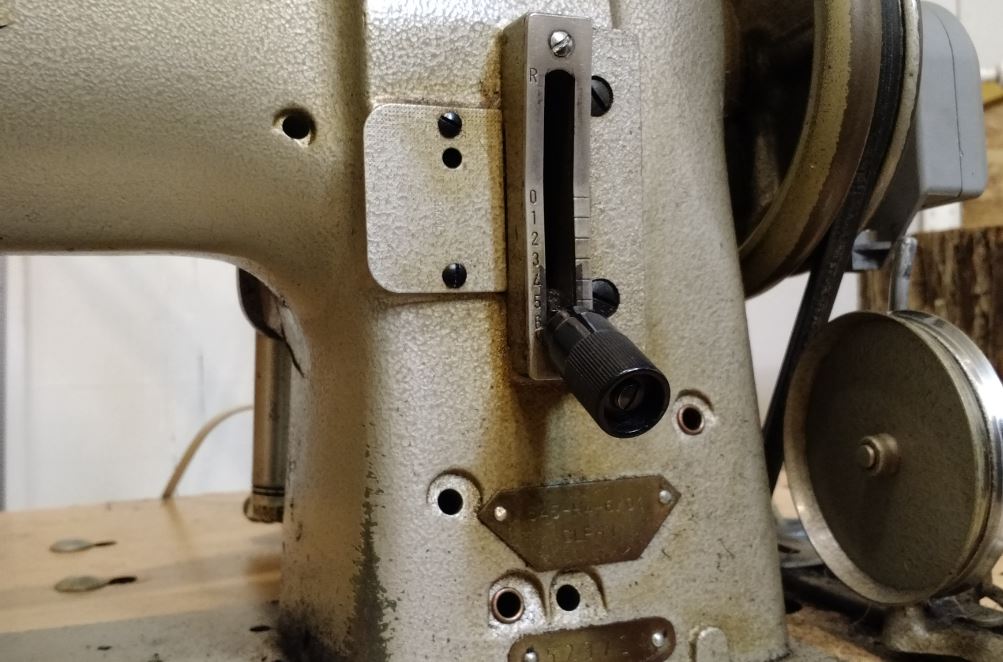

Thank you Uwe and sandyt for all of your very helpful information! Here are some more pics of the sewing machine setup. Uwe, I have included a picture of the end of the power cord, do you know if there is an adapter I could get to work with the converter you mentioned because it doesn't look like it would work with the converter. I would rather use a converter than run a new circuit line. And this sewing machine needs to be cleaned up. I have also included the extra parts that came in the drawer of the table.

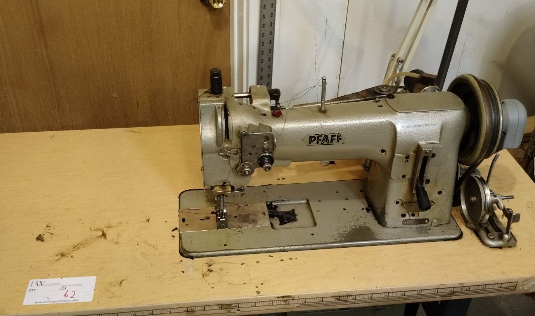

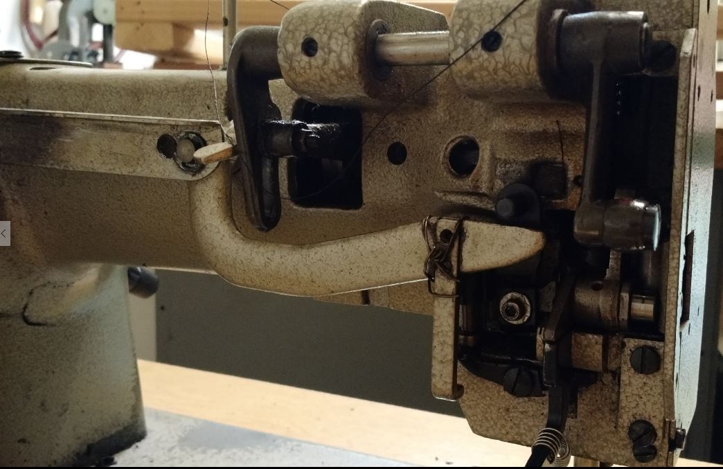

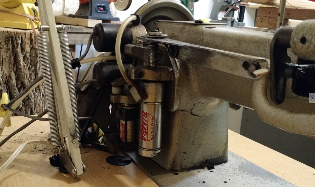

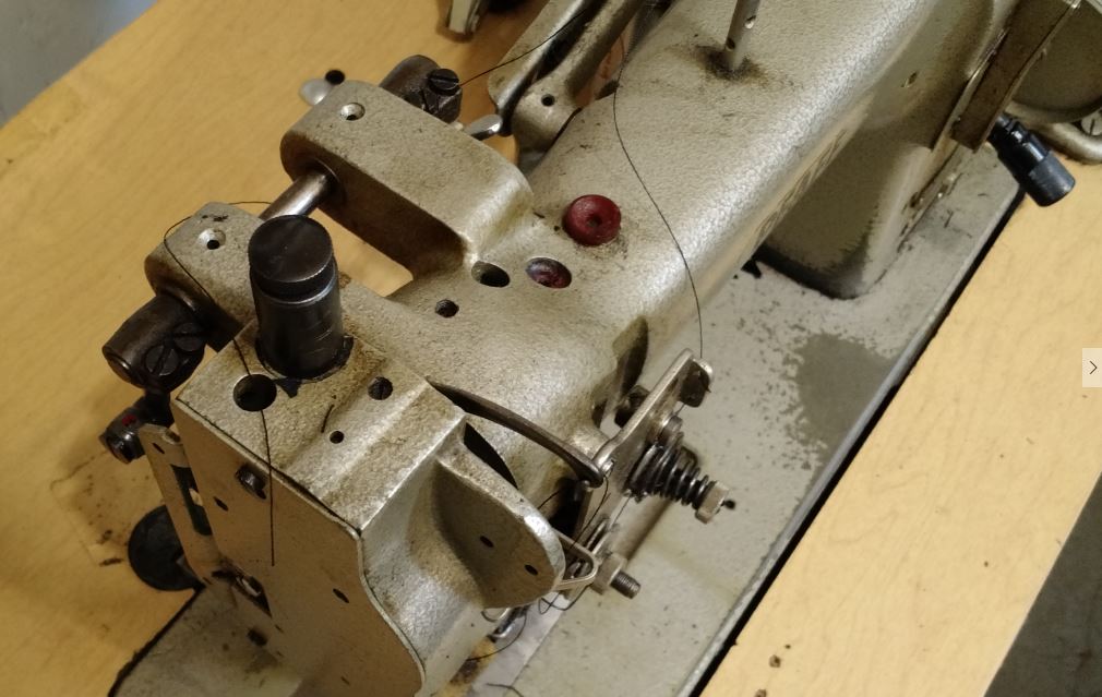

Ok, I got a Pfaff 545-H4-6/01. I know this is a really good machine but now I am trying to learn it and I could really use some help. I am very new to sewing machines but I am going to do what it takes to learn them. The first thing I need help on is the motor, I want to put a servo motor on it for better efficiency and being able to sew at slower speeds etc. but this machine has a lot of extras I have not seen on a machine and I do not know what exactly changing out the motor would involve. I am attaching a lot of pics to show what is on this Pfaff. I cannot even turn the motor on yet because the power cord is a 2nd phase cord (I think) and I only have the standard outlets in my shop. Anyways the motor is a Quick Rotan Synchro 6040. One thing that has me kind of baffled, the guy who I got the machine from said something about needing an air compressor hooked up to raise the walking foot. I think that is what he said but I am not sure if that is exactly what he was talking about. So this is a clutch motor right? Can I change the motor out and put a servo motor on the Pfaff? And what are all of the extra hookups on the back of the machine head? Thank you in advance. I can also take pictures of any specific part of the machine if someone needs to see it. the first 9 pics are of the motor and the last 3 are pics of the attachments on the back of the head of the sewing machine. Thanks a lot!

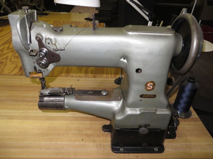

Thanks Gump, the sewing machine I am looking at must be the 153 k 103. I know nothing about sewing machines but I am trying to learn because I have this Singer I am looking at. Any information you have on it would be helpful. For instance, I don't even know what thread size this Singer can use. Here is the best picture of the sewing machine that I have Uwe, I cannot read the model number because the picture is too blurry. That is why I thought it was a Singer 152 k 103, because that is what it was listed as. Thanks!
