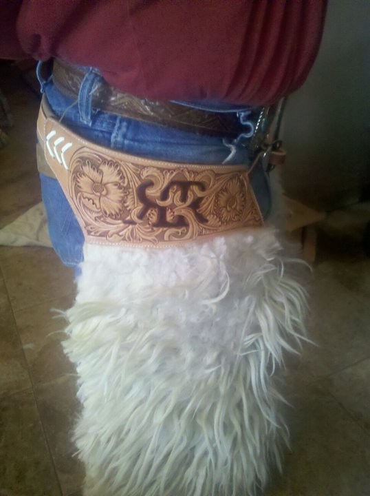

				My First Pair Of Woolys
customcowboyleather replied to customcowboyleather's topic in Floral and Sheridan Carving
Thanks Bill. They looked good, until you could get close enough to smell the hide. My customer had that old hide for over 20 years, and it still smelled like a piss covered goat......But my customer is really Ranchy, and as far out into the high desert as his ranch is, only his dogs will have to worry about the smell.....It diddnt seem to bother him when he put them on....but it was all I could do to work on them in my shop..... As for the antique..... I first died the brand in the center with Cordovan liquid die. Then added a very light coat of leat-lac to the yokes....let that dry for a couple hours, and then appied a coat of Sheridan Brown antique paste with a small piece of sheeps wool, and wiped it off immediately with a clean rag..... and that is the result....thanks for your comments Bill. Hope that Helps, Happy Toolin' Justin Alps -
