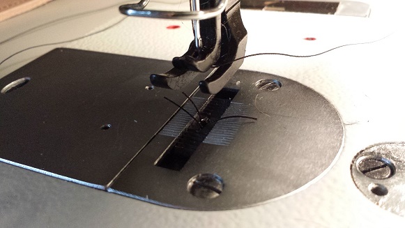

Need Help With Bobbin Issue On My Consew 206Rb5

Thank you Gregg. The white spot on the pulley was hidden by the upper belt guard. Now, it's been removed and I can see it clearly now. -

That was my problem. It truly wasn't at the highest position to release the bobbin thread. I was trying to pull it our before it was truly released. This is an easy adjustment. Thanks for the advice and help !! -

That's really a great idea about the bobbin cases. I will grab extras. Yes, I do hang on to the extra thread for the first few stitches. It is a great machine, and I don't know what has happened. My wife has used it a couple times, and she said there were no issues other than a very small bobbin birds nest where I think she forgot to lower the presser feet before sewing. I am getting frustrated with this. I wonder, since the only real issue seem to be when the bobbin thread is released, I wonder if the needle positioner isn't off a bit, and I'm just assuming it's at the top of the stroke? Going to go try that now.... -
Good Afternoon Folks, I need some help with my Consew 206RB5 This machine is basically new, has less than 4 hours sewing on it. It recently started acting up on me, and as you can see from the attached pictures, it seems to be doing something goofy inside the bobbin. I have made no adjustments since receiving the machine, and no thread size changes. Still running #69 thread. Any ideas? I will say this machine is a bit of a pain to remove the bobbin. The manual says to remove it when the needle is at the top of the stroke, but the bobbin will not come out at that point. It slides out easily when the needle is almost flush with the plate. The needle and hook timing looks good however, it appears to really check it you have to pretty much dismantle the feed dog. In reality, I have a needle positioner, and when I back pedal it, the needle goes to the highest position. There is no way the bobbin will come out at that point. It will only come out when the needle is about flush with the feed dog and is best removed or inserted when the needle is on the upstroke and clear of the bobbin housing. Any suggestions?
