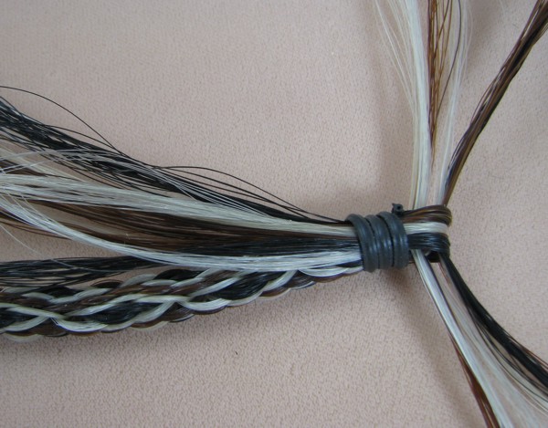

  18. Hi Joe - I don't want to derail this nice thread about Gaucho braids so I'll just keep it very brief. I tie knots in the end of the bundles! I use a needle but one end of the hairs is loose and it *will* come unraveled if I am not careful. I can't just stop in the middle of tying a knot. Also I have to be careful because unlike leather, where each piece stays separate, all the hairs crowd together so you can't tell which hair is in which bundle and where it is going. So I can't use those "quick start" methods for example, where you lay a whole bunch of passes together before starting an interweave. It just turns into one big mass of hair and you can't tell if you should go over it or under it. I did a pictorial step by step (it's not meant to be instructions - there are lots of better writers out there, people should get instructions from them) so you can see - Braided horsehair bracelet one step at a time.

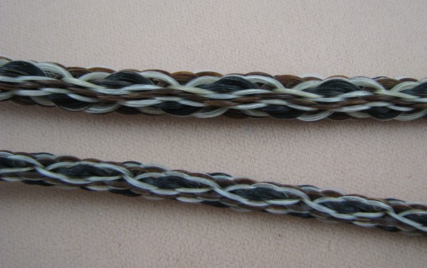

  19. Now, come on! We all know it's not your eyes, it's my photography... See if this is better, I don't usually take them this close up: Not the same bracelet but the same braid. It looks different in horsehair from this close. But hopefully this is close enough that you can see how the strands went. I thought this color might be easier to see; my standard colors are black, white and "sorrel" (which is a pretty variable color, but basically a reddish brown) and I think black and white are sort of hard to see the details. Anyway I really love this braid, and I'm thrilled to see it in leather braided over a core - it just looks terrific. If you look at my avatar the base braid the knot is tied over is a gaucho also but it's a 12 strand not an 8. One of these days when I have a little time I want to sit down and work out a 16.
  20. Nice bracelet! And Leatheroo, nice necklace! This is a braid I use every day in my work. Depending on what you braid it from it is intrinsically a round braid. That makes it perfect for horsehair - Even with no core it comes out round. I am so happy to see others using it! This is what it looks like in horsehair: No core of course. Horsehair has quite a lot of "life" all on its own.
