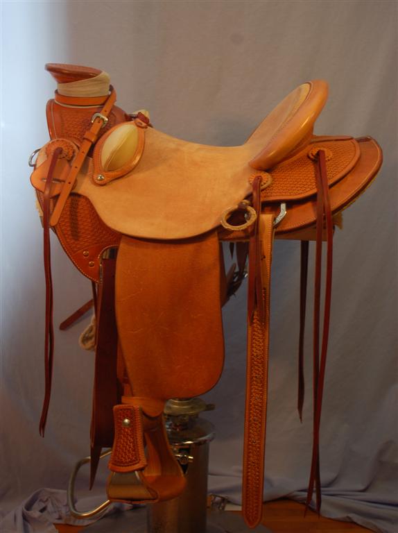

I finally got enough gumption to post my first saddle. I cannot thank folks enough for their help both personally and with the help on this site. I went full time this spring and so far I barely have my head above water. I have been busy in the repair business, braiding and some small tack items. This has been a dream of mine for some time to build saddles. This one is on a Sonny Felkins Tree, with an all leather ground seat. I am in the process of starting a second, on one of Denise & Rod Nikkels trees. There is quite a lot on this one that I hope to improve on. Enough said. I would ask for any help and critique that ya all can give me, and it would be greatly appreciated. Living in this part of the country makes it a little difficult to get any help, so I have relied heavily on this site, books, videos and the help of an elder gentlemen (retired saddle repair business) and friend who never built new saddles but greatly supported me and offered as much advise as possible. He comes to my shop almost every day and has been my best advertisement. I have spoke with some of ya all over the phone and cannot thank you enough for taking the time to talk with me. Thank You, Tom

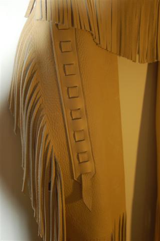

Hi Steve, Great looking pair of chinks, I really like how you turned the fringe around to get the different contrast. Sometimes the most simple ideas have have the greatest effect. Never seen it done before. I have been toying with having a friend make a scalloped pinking punch like the one you used but it is not exactly priorty on his list as he shoes for a livin and has a hard time findin the time. Can those be purchased somewhere or did you make or have it made. I got a pair of chaps years ago and I always liked the effect of a scalloped edge. It just seems to set things up a little extra ordinary. Tom
