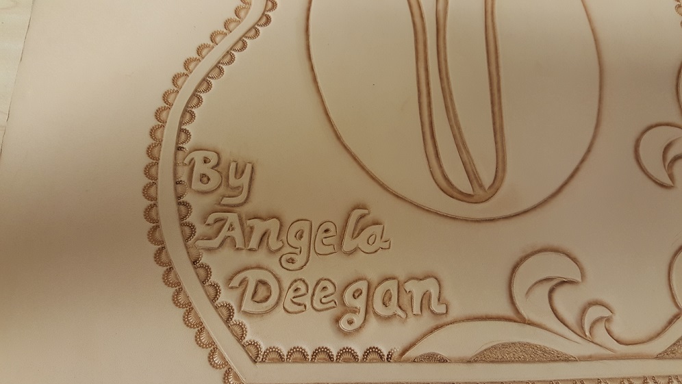

Thanks for your response Bob. To answer your question, Yes i am leaving the letters plain with no backgrounding. How would you recommend getting into the pin size spots for example, in the dead spots in the e's and a's? This is where i struggle the most i would say since it is very difficult to do anything with these areas without ruining the actual letter itself.
Hi Everyone, I have been having some troubles perfecting my beveling for very small objects especially letters. Can anyone give me some tips on how to better tool these areas? i am using the smallest beveling tool offered, and try smoothing areas out with a modeling spoon but it doesn't seem to be doing the trick. I think it still looks a bit sloppy. I've included a couple snap shots of the order i am currently working on. Thanks

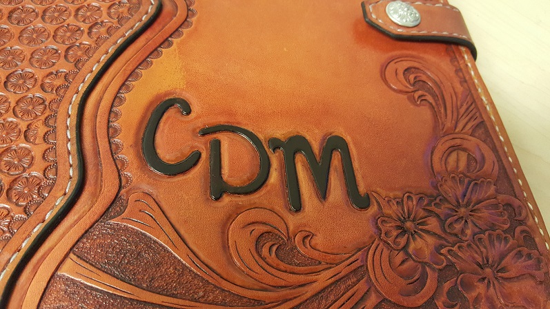

Thank you everyone for the kind words, i really appreciate it! This is what i ended up with after finishing out the background areas throughout the entire piece. Now on to finalizing it!

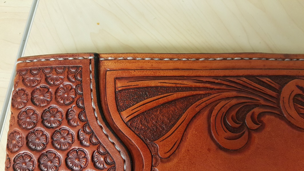

I think im going to have to be happy with the overall look at this point and not try to remove the base layers of balm i applied. going forward, i just need to figure out what looks the best for the background and my thoughts are leaning towards the darker color like in the picture. Does that look good ( around the name area), if so, ill just need to darken the rest of the background areas to match. If it doesn't look great, i am looking for other options. It doesn't have to be "light" in color, i only wanted the surface color to be lighter, which it is fairly light i suppose.

What are your recommendations for background coloring on this particular piece. Right now as it stands, the album has an orange/red tint to the background, around the name on the spine. I put a darker brown to see what it would look like that way as well. Any recommendations?
Hi Everyone, I am having a bit of a problem with finishing a particular piece. After i had all of my tooling finished i applied a couple coats of Fiebings Leather Balm and let it set for 24 hours. I chose to use Eco-Flo Saddle Tan Gel Antique for this photo album. It seems to me that it's a bit too "yellow". I have thinned it out as much as it would take off with water and polishing it with a rag. Also i am having a hard time figuring out what to do with my background. I wanted to keep everything as light as possible, but not sure that's much of an option anymore. If anyone could provide some tips or opinions on what i could do to improve the overall appearance of this piece, i would be in debt to you!! Too many hours of tooling to be unsatisfied with it. Thanks for taking the time to read. KB Custom
