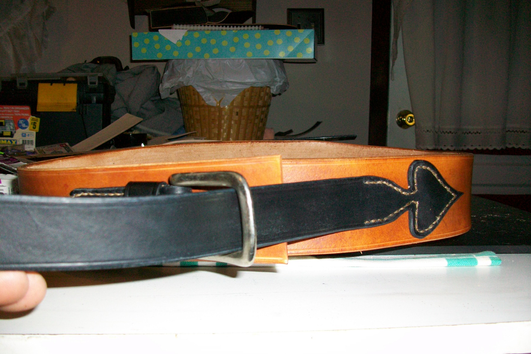

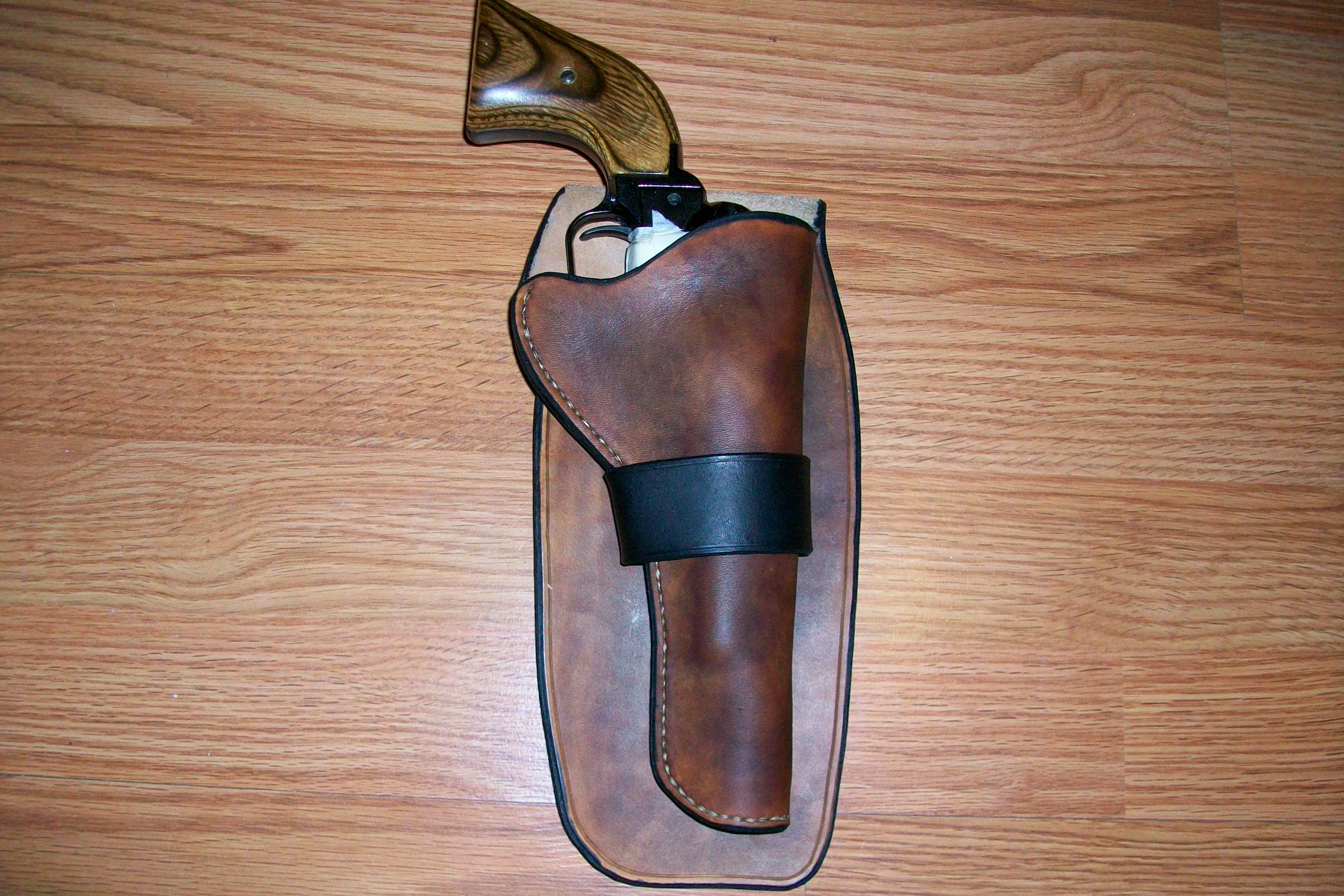

  1. This was my first holster rig for a friend in SASS. Wanted to keep it very simple, with smooth and clean lines. There were 2 holsters, but I only took pics of one, and the belt had bullet loops in the back, which were done in black also. And just to keep with the old west motiff, the billet where it was stitched to the belt body was done in the Ace of spades pattern. Thanks for looking, Woods

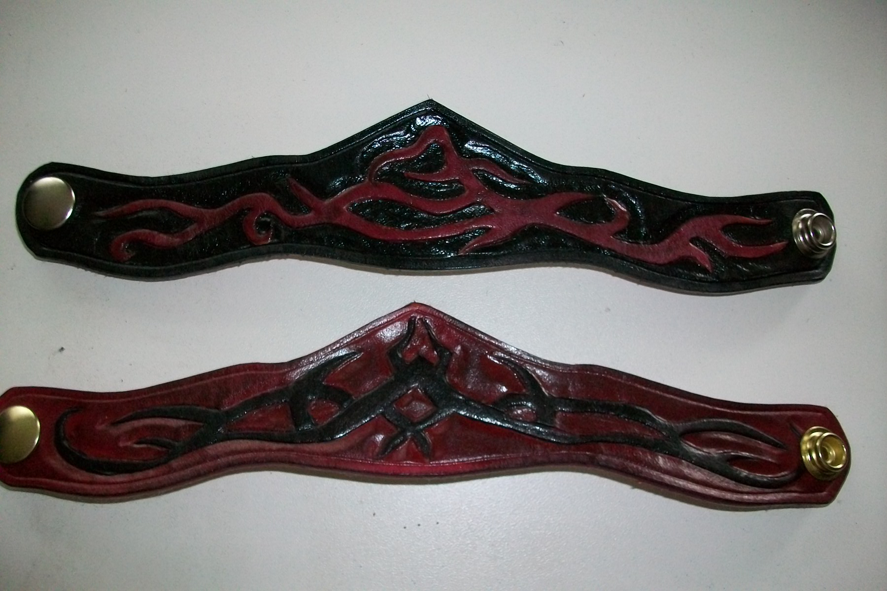

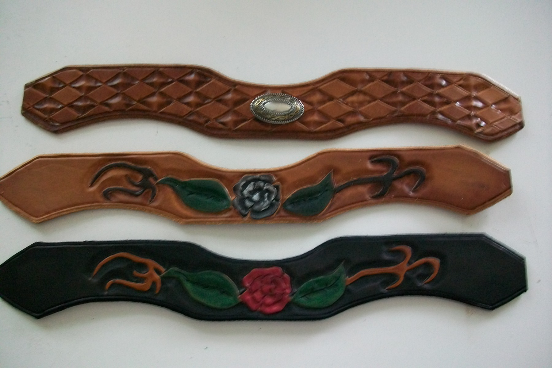

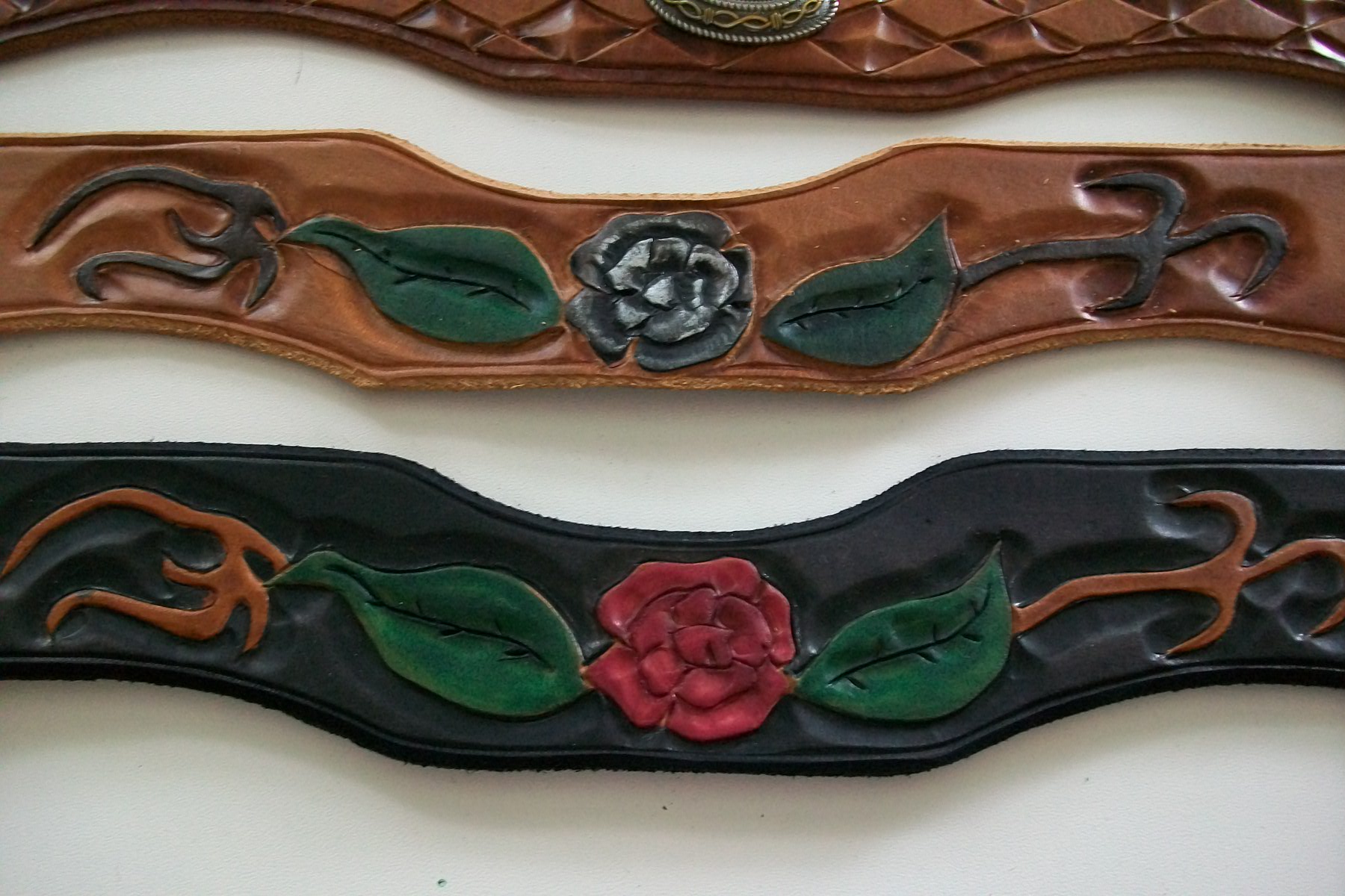

  8. Well, lets see if I finally got this figured out (posting pics) Please excuse the poor quality of the photos, I'm just glad I was able to get them to show up! Any and all critiques are welcome, and I hope some folks enjoy, thanks for looking. The first 2 pics are of neck collars, but are just short of being finished. The last pic is two of the leather bracelets I "made up" as I was going along. Eric Woods
