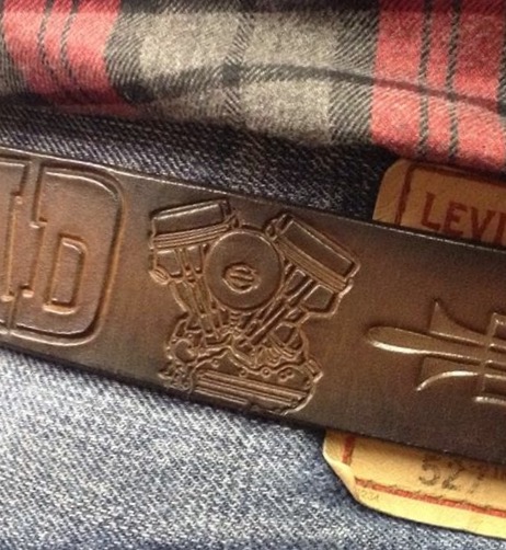

Yes this is a Panhead.. I was hoping to find the panhead, knucklehead, flathead and showel for a friend :-)
Does anyone know where to find these Harley engine leather stamps, or do you think it's a custom made stamp? Marius
