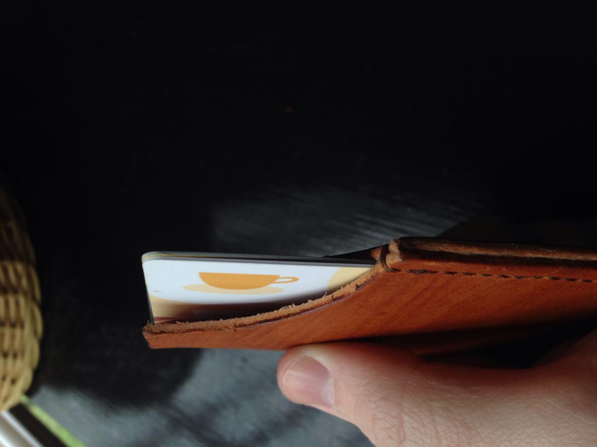

	I've been making some basic card wallets of my own design. Please let me know what you think. I'd be happy to receive any critiques, tips, pointers, etc.

you mean both sides of the edges? I haven't beveled anything yet. I actually don't know what it's suppose to look like to be honest. -

Oh I misunderstood. I really love the look of the saddle stitch haha. Thank you. So since I've already slicked my edges with gum, do you think it will be ok to bevel the edges still and then slick them back down with gum again? -

Thank you, kiwican. I actually have a couple of beveling tools. I know it may not look too much like it, but I burnished the edges, I just didn't dye the edges (probably would have looked better if I did). Would you recommend beveling the edges after it has been burnished already? And then maybe going back and burnishing it again after beveling? Also, I thought I did a saddle stitch haha. I probably messed up some where. Was this not a saddle stitch? Have any good video links for learning saddle stitching by chance? Thank you again. Blessings, Tyler -
