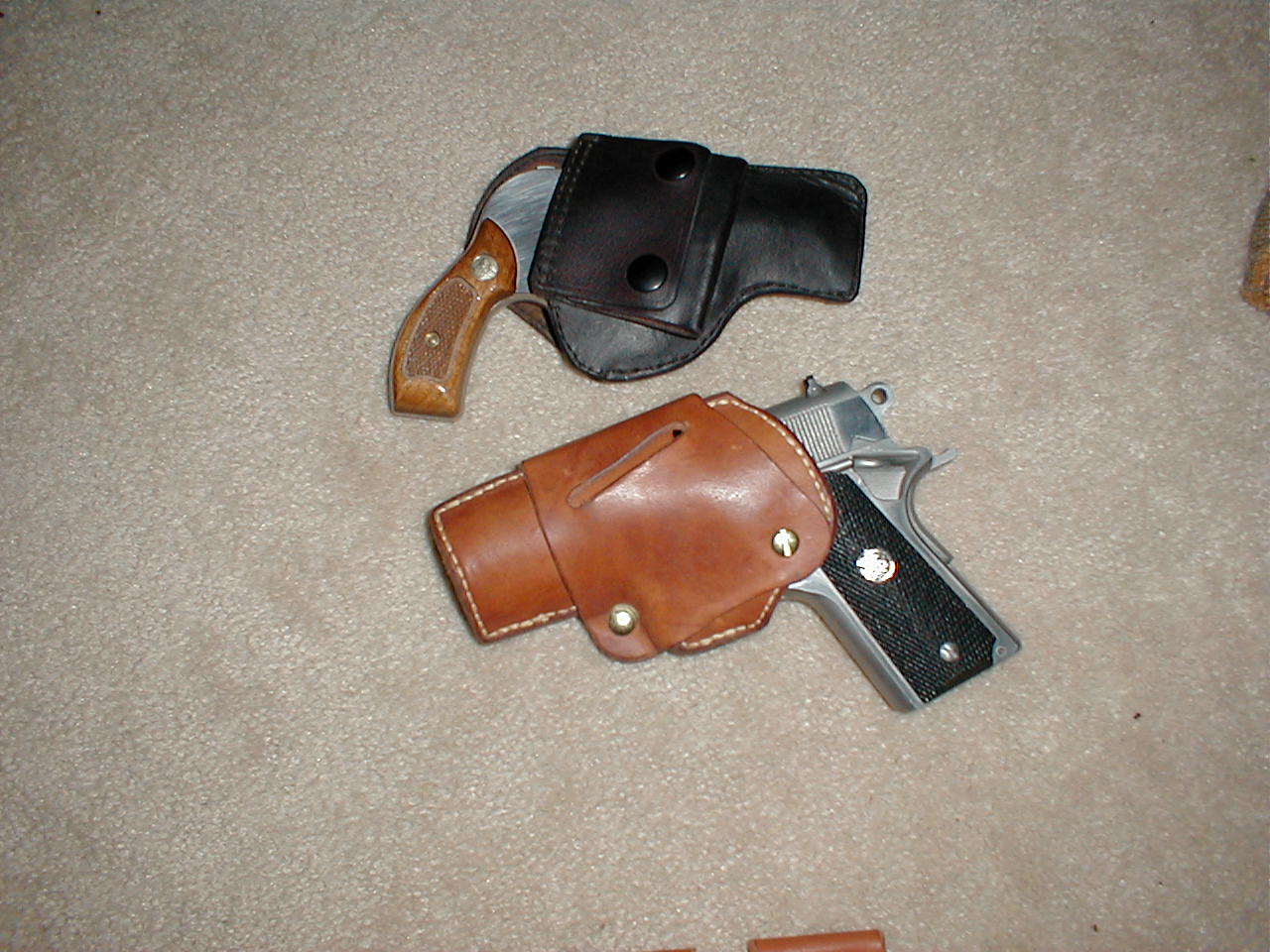

And? What do you think? Critiques welcome. I can always learn from others. WW
Yes! Send them to me. I regrind them, add handles, and make precision scribers and awls from them!! Mail me at goboom@bellsouth.net . Bill
Some of my latest holsters

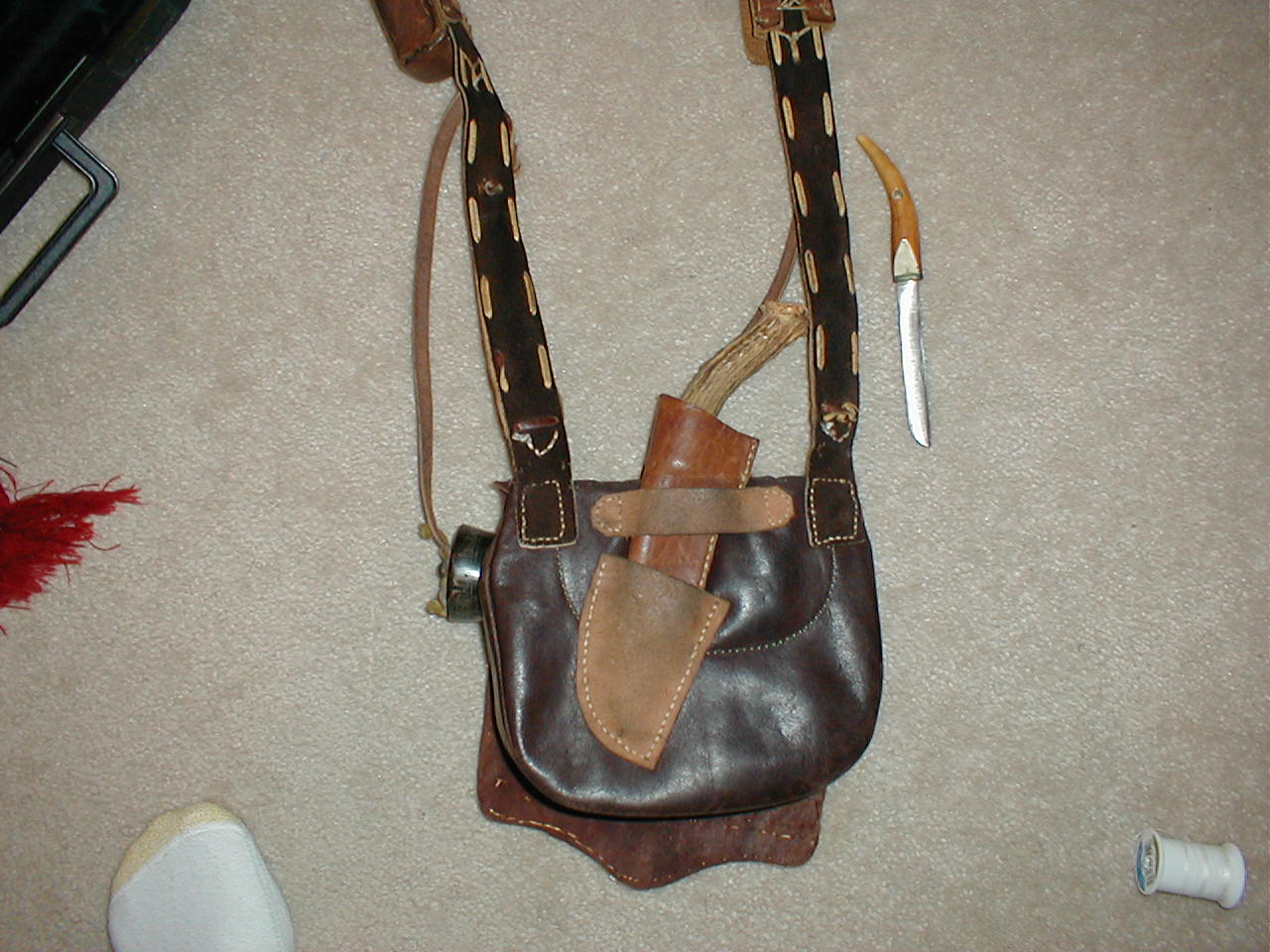

..............and my foot. I just noticed. Well,at least I was wearing some socks....... WFW

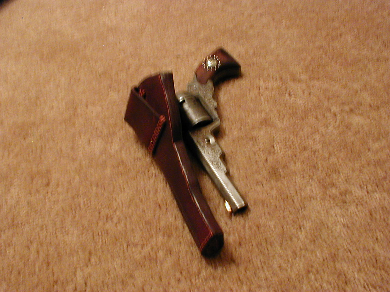

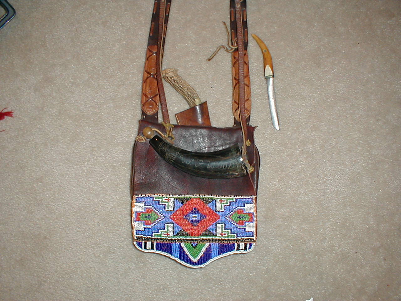

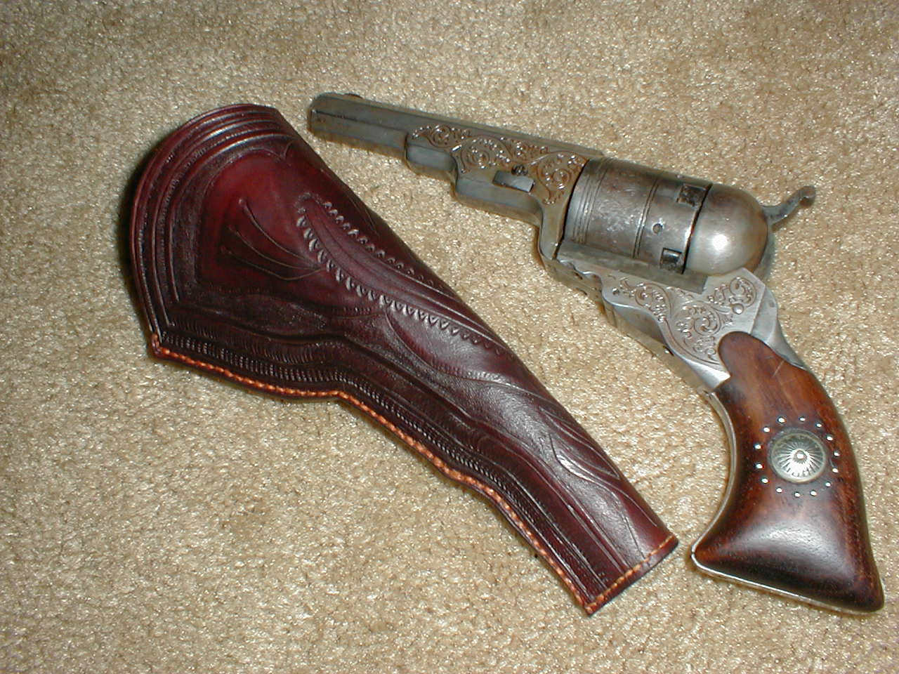

Some of the last post included some really bad photos (Didn't know they were still in the file!) Here are some better ones (I hope!) More later. WFWood
Some of my latest. The .31Cal. Clot Patterson is a replica customised for a friend, and the Slim Jim is tooled in a pattern peculiar to the 1849-1859 era similar to a known Main & Winchester (SF, Ca.) holster they custom made for a cut down Patterson. I shortened the barrel and added the brass cone front sight (as per the original) and had an engraved add the engraving. The rest are Possibles bags and some hnives I made, with a couple of possibles bags I made (and make!) WFWood
