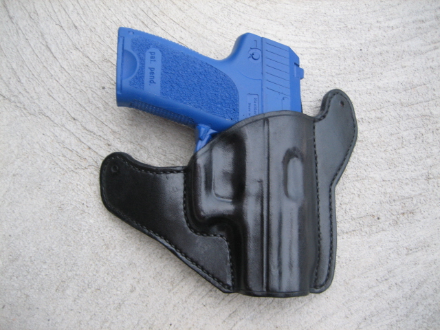

Looking for some suggestion on how to cover snaps, rivets, etc. that would be exposed against the gun. I'm working on my 1st thumb break for an OWB (I've mostly been doing IWB for true concealment). Against the body I was going to double the leather at the snap point w/an insert to stiffen. But on the "strap" piece coming over the gun, how do you cover that snap to keep from riding against the gun? I thought about sewing in a liner but I figured that could wear through over time. Any thoughts would be appreciated. Thanks!

I agree that it presented some challenges for a newbie, but now has bad as I first thought. Still room for improvement though, but when won't there be?!? Thanks for the advice! At first I was concerned that having the butt loop closer would interfer with draw but found with the right pattern and cant it should not affect it. The butt loop will be moved closer on future designs.
Thought I'd post a finished picture. I've learned some more and will make some changes for the next one.

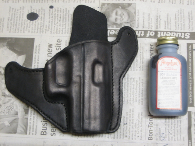

Wickett & Craig 7/8 oz leather Angelus Jet Black Dye I am in the process of applying dye so there is no finish coat yet. I just got some various color dyes from Angelus so I'm anxious to see how the finished product turns out compared to Fiebing's (which I have not been overly impressed with but could be user error). Here are some pics of my latest. One picture is after wet molding and the other after dye. Please fire away.
