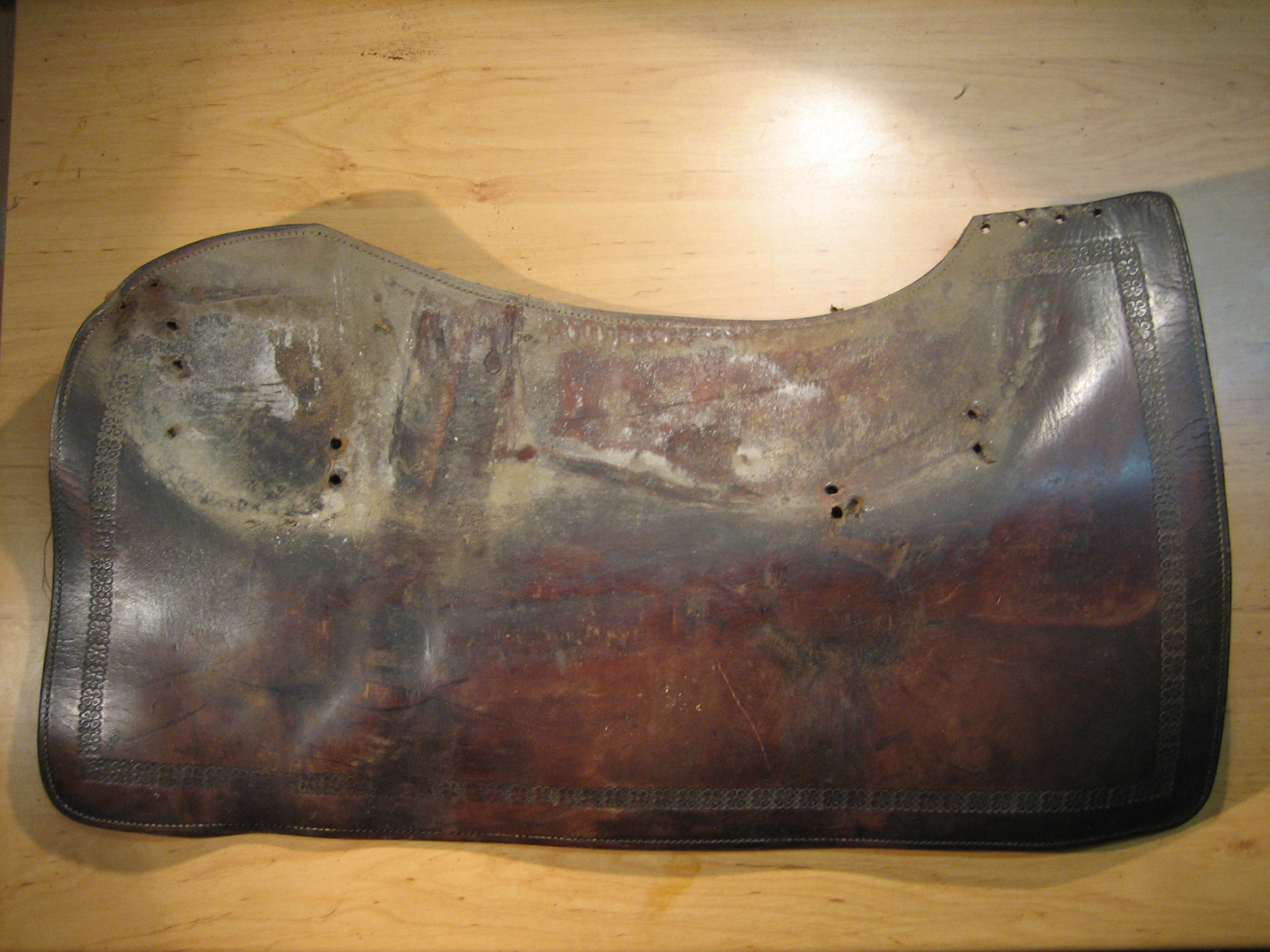

Ambassador Don101 Posted November 9, 2007 Ambassador Report Posted November 9, 2007 ERM ups Sorry i some how missed this one too, yes as explained above a bit of soap and warm water not hot water goes a long way, then i just oil and then use a leather restorer that also has beeswax in it, it is a cheeper version than black rock but does the same job, here are two pics before and after, Don Quote
