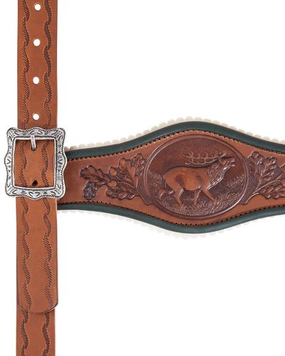

As a follow on question, I'm still looking at options on different design details.  I came across this set of suspenders and I'm a bit perplexed by how this edging was accomplished.  (the green portion)  It looks like it was sewn face to face and then rolled over the back, but then it had to somehow be secured to the back, as well as the white backing piece.  Does anyone know what this is called and/or how it's accomplished?
The entire piece (brown and green) is one piece of leather.  The green area is died a different color than the brown.

I agree that there are some beautiful oak leaf and acorn designs that come out of the black forest.  However, the ones I linked are made by Max Töpfer out of Ergolding, a bit north of Munich.  Regardless, the central design isn't what I'm going for, but that edging caught my eye.

So, not to be argumentative, but the more examples I've seen, the more I think that the colored edge is actually a separate piece of leather.  I'm thinking it's basically glued and rolled over the edge and either stitched through or with a separate stitch running below it.
hosentraeger_03_2048x.jpg?v=1475933705
The edging reminds me of what pinking shears do on fabric.  I've seen some advertisements for pinking/edging machines under leather working machines on ebay.
